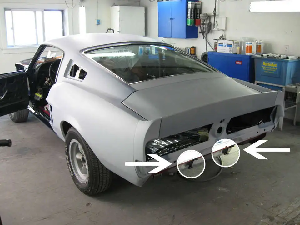

Holy Cow! Do I have to put circles and arrows on an 8x10 glossy? OK!
In the spirit of Thanksgiving and Alice's Restaurant, here goes:

2+2GT said:
67-68 rear bumper guard bracket.
Yep, that's what they are! Thank a lot!
now I can put them away - I'm not going to have bumper guards at all.
