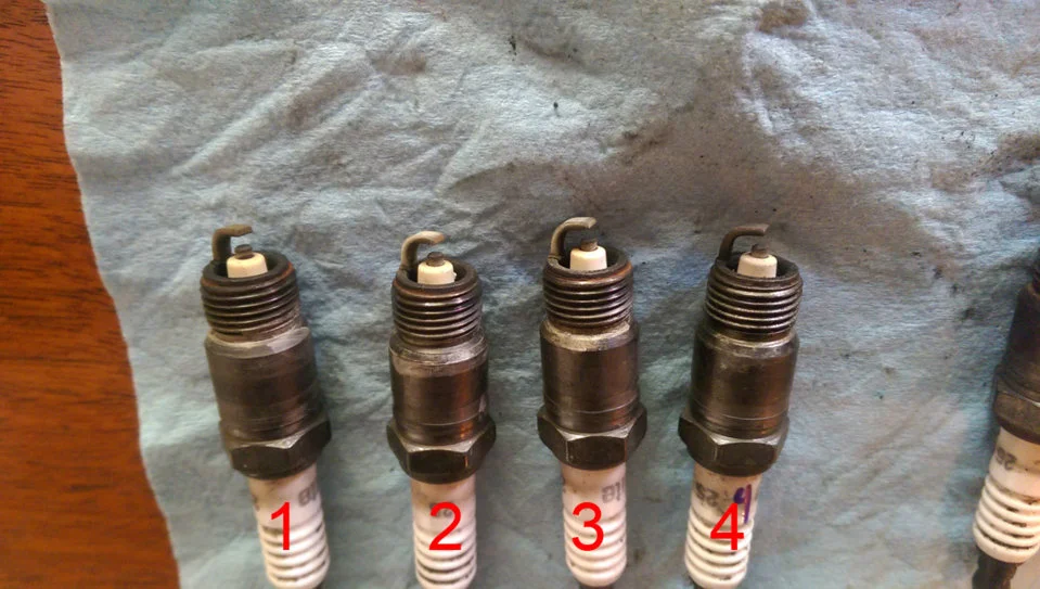

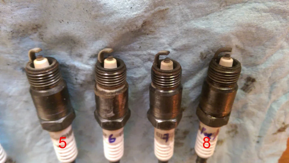

I'm not good at reading plugs or diagnosing, so I hoped the community could take a look.
A little background:
  • in the last few months car has been having to crank a lot before she fires up.
  • Also I've been killing catalytic converters, 3 pairs dead in 2 years. The first two were both the CA magnaflow aftermarket. 3rd set is a used H-pipe, that didn't rattle when installed then after a month broke apart inside like the magnaflows. Throughout my mechanic says there are no codes and every things seems fine. He had the car run the compression and injector test.
  • Though car has no stored codes, every once in a while the 'check engine light' randomly comes on. Once while I was leaving the shop, it turned on for about a minute then turned off. I immediately turned around and had my mechanic plug it in to the computer; nothing.
Convinced there is something else going on, I've ordered a vacuum gauge and was going to tackle testing the vacuum lines with jrichker's how-to post.

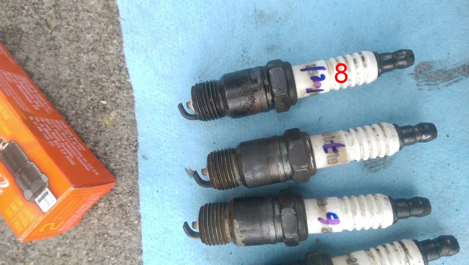

In the meantime, I was replacing plugs and pulled plug #8 and saw it was shiny with a bit of fuel around the collar by the threads. In the photo, you can still see some residue on the plug. I read a gunked PCV valve could cause a wet/oily plug 8 so I've ordered a new one.

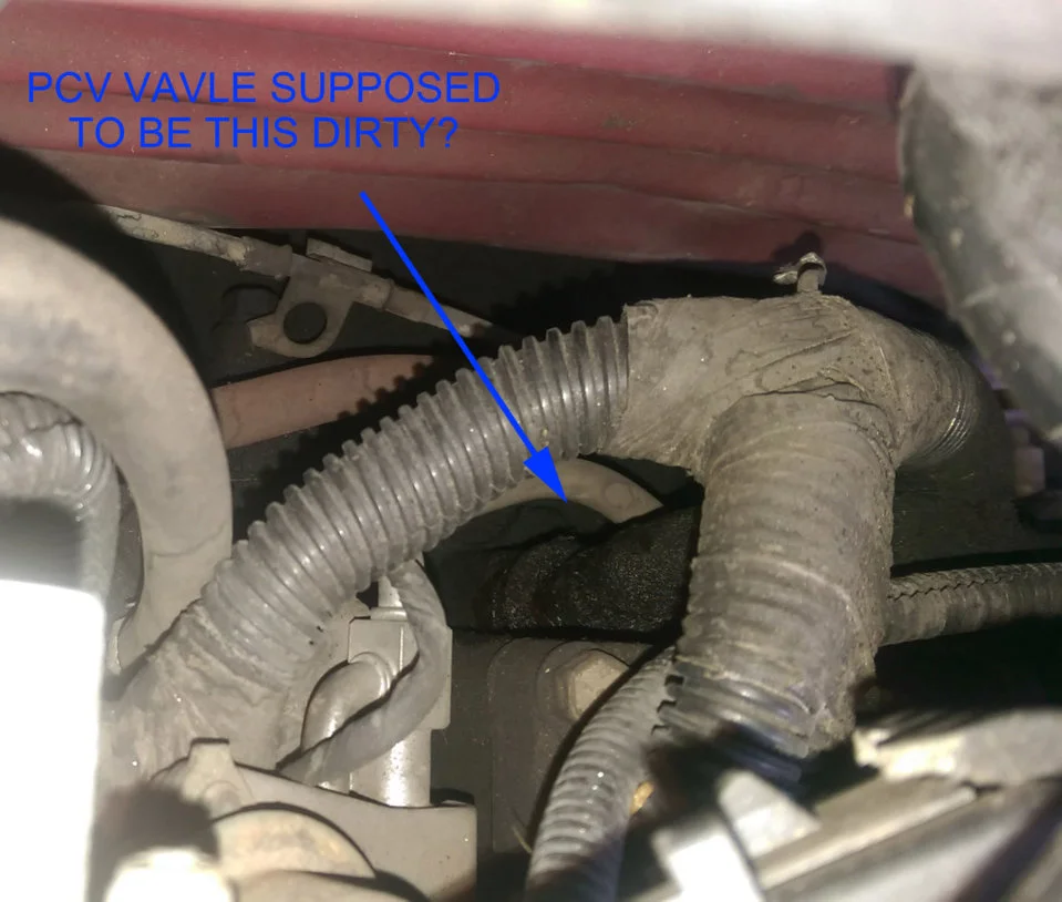

  • Could a gunked PCV valve also be part of my issue with my cats? I've owned the car for 22 years and have never had it replaced or cleaned. Attached is a photo, of what I think is the PCV valve, is it supposed to be that oily/dirty?

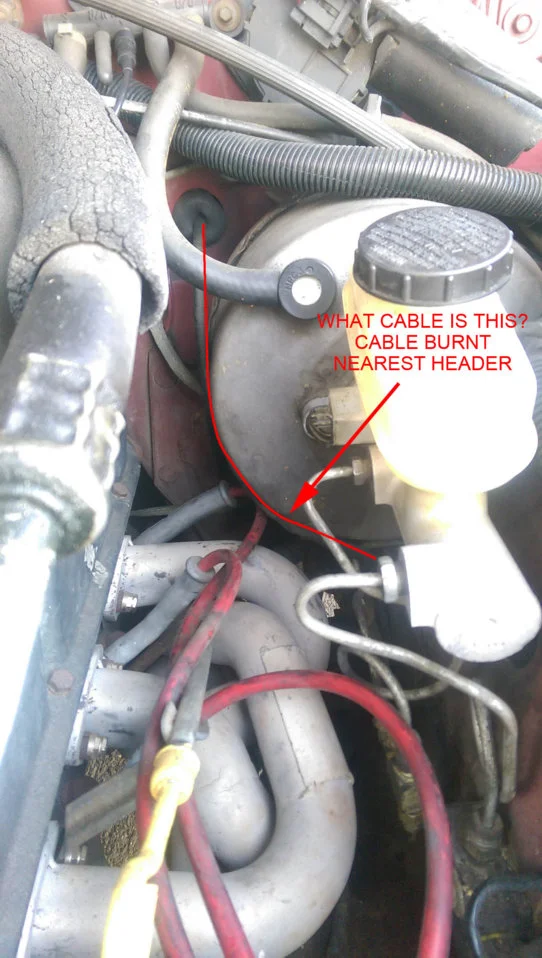

  • Also, in trouble shooting vacuum lines I found a burnt cable (hose?) near the brake booster. Anyone know what this cable/hose is to?
  • How do the rest of my plugs look?

The cable in the picture is most likely the clutch cable.

car is AOD, would it still have a clutch cable?

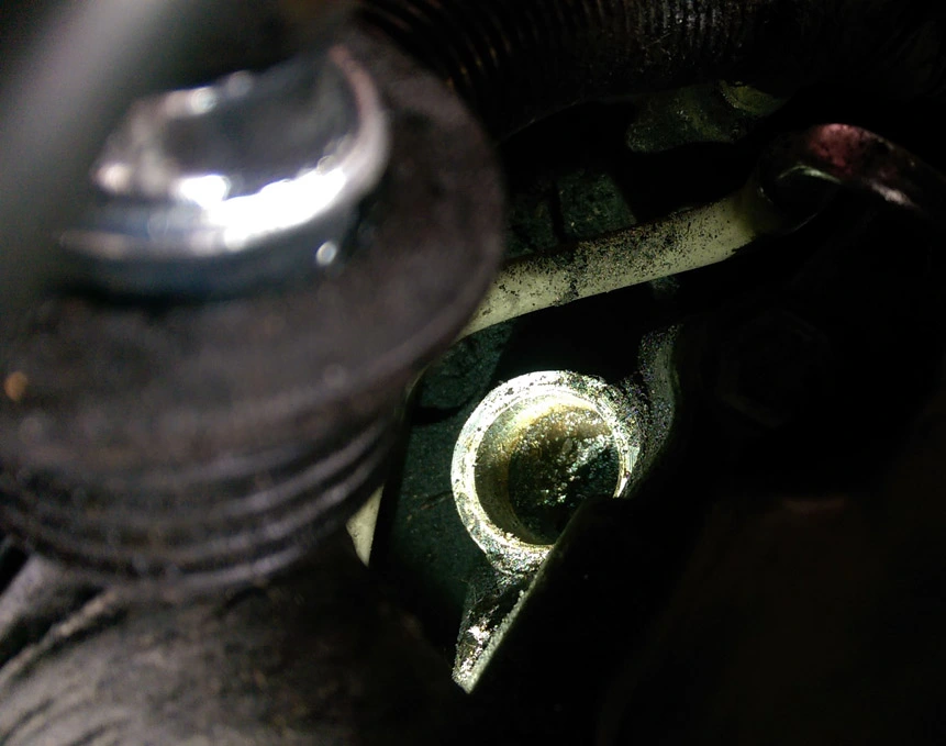

The PCV valve came out fine from the neck on the engine. But the valve was stuck pretty good to the tube. Unfortunately when i tried to pull it apart with a wrench it exploded into pieces. My replacement valve is made of metal but evidently this one was made of brittle plastic.
Also I can't find the PCV filter. Is it possible it got pushed far down the neck? I used a long wood screw to try to hopefully grip something down there. It seemed to grip to something but that could have been the threads catching on the neck. I'll attach a photo for reference. The screw would always pick up a little grease every time I put it down the neck.
  • Assuming the car has had no PCV filter for the past several years, what symptoms would that give? Does that lead to more things I need to check?
  • If the filter has been pushed down the neck, how the heck do I go about pulling it out. I barely have enough room to see the top of neck where the grommet sits.
  • Also, I just realized some shards of plastic from the broken valve "could have" fallen down the neck. Engine currently running fine. I guess I'll add that to the list of things to worry about.
Thanks again for any insight.

That cable looks like the speedometer cable.... The screen should be in that hole. If it went all the way through it would be laying in the lifter galley. Don't think it could fit all the way through. Back in the 90s people used to take them out and throw them away...bad idea for our cars. If its never been changed its probably a block of carbon. A lot of things can cause a cat to fail quickly. The most common is running lean....it heats the exhaust gas and can melt cats. To see how the car is burning fuel you can get a cheap air fuel guage...they tap into the o2 sensor wiring. A wide band guage would be better but way more expensive than the "el cheapo" norrow band type.

How much of the top end would I have to take off to inspect the lifter galley? I'm in apartment living with no parking space so anything too invasive might have to be taken to the mechanic.
