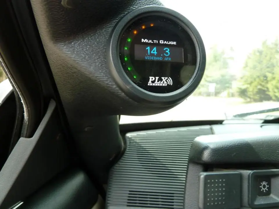

Here's the initial reading. This is full throttle 3rd gear at about 5000 rpm. Looks like the 19s are leaving me lean. I have the Kirban adj reg so I'm gonna bump pressure 2lbs and check again. I'll update later because I have other obligations that take precedence.

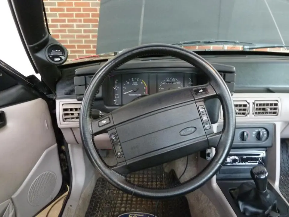

looks good,single right?.....if you get a chance take a pic little farther away?,i want to run a single also....
Yes, single. I mounted is lower. When you look at the car from the side, you cant even see it. It hides behind the mirror when viewed from the side of the car.

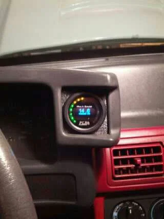

http://www.amazon.com/gp/aw/d/B008LTPGOM?pc_redir=1396175002&robot_redir=1
$200 bux gets you the touch screen multi gauge, the solenoid module/controller and a Bosch wideband oxygen sensor. It can display several different sensors at once with digital readouts and graphs.
I also have the boost solenoid hooked up and can toggle between then simply by touching the screen. Love mine....
