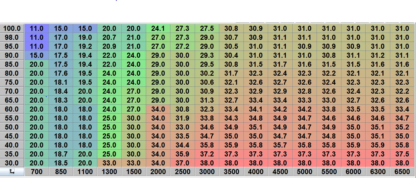

I had a look around for some better examples of timing tables for a N/A motor somewhat close to what I'm running. I ended up adjusting my timing table again tonight. It looks better, and my cruise timing was bumped a fair bit. It's still somewhat conservative for mostly running 94 octane. I have run 91 on occasions without issue, but prefer the 94.

I ran out of time tonight to review your progress, but from glancing at the timing table you posted it looks like your in the right direction, I would err on the side of caution in regards to WOT timing at your comp ratio.... I would hate to see a tank of bad gas end your fun. Stock a9l ecu with 9:1 comp and 87 octane 28* total. most guys get pinging with 32* total and have to run premium fuel.

No problem, I'm just very appreciative that you're even looking at it, and offering your advice and knowledge. BTW, the AF gauge seems to have become somewhat noticably more stable at idle than before. It appears the AF/EGO Control changes had a positive effect on that perhaps. Also, I'm taking your advice and backed off the WOT timing a bit.
