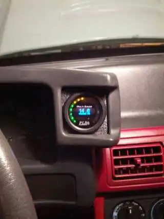

You may have seen this already, but here's my mounting
