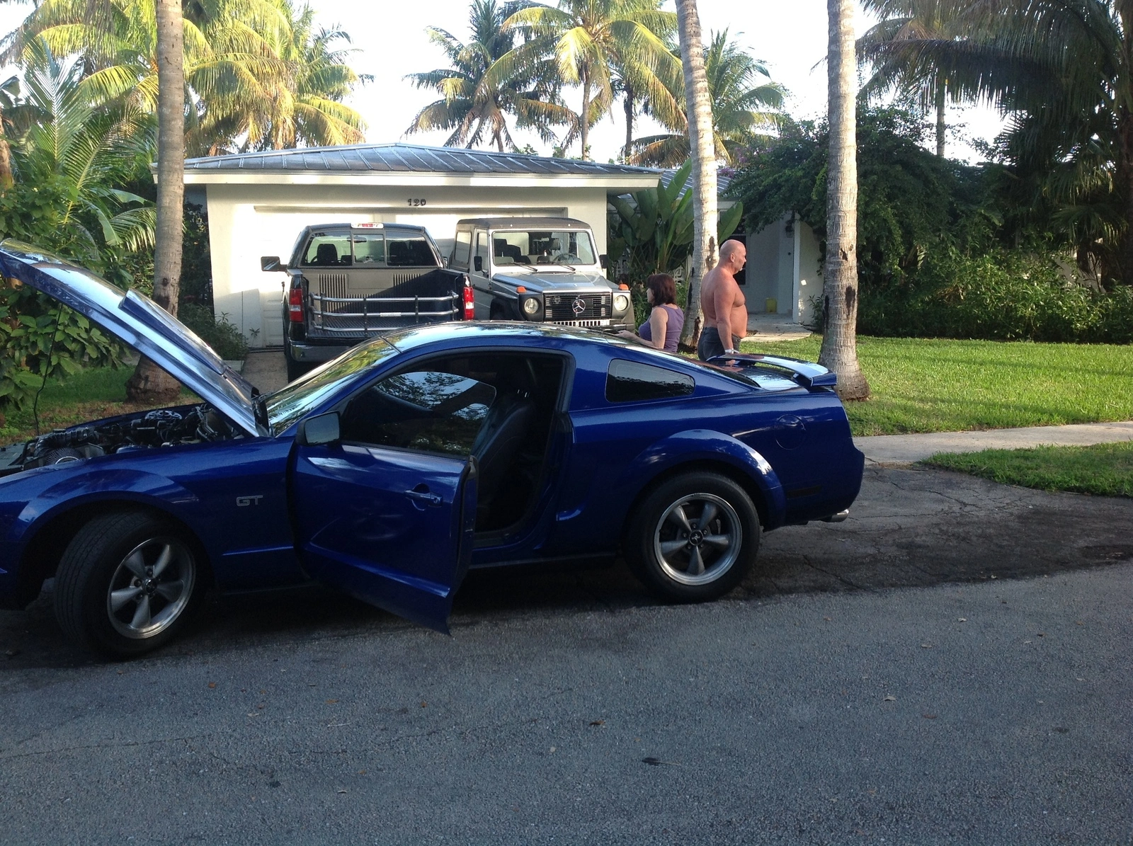

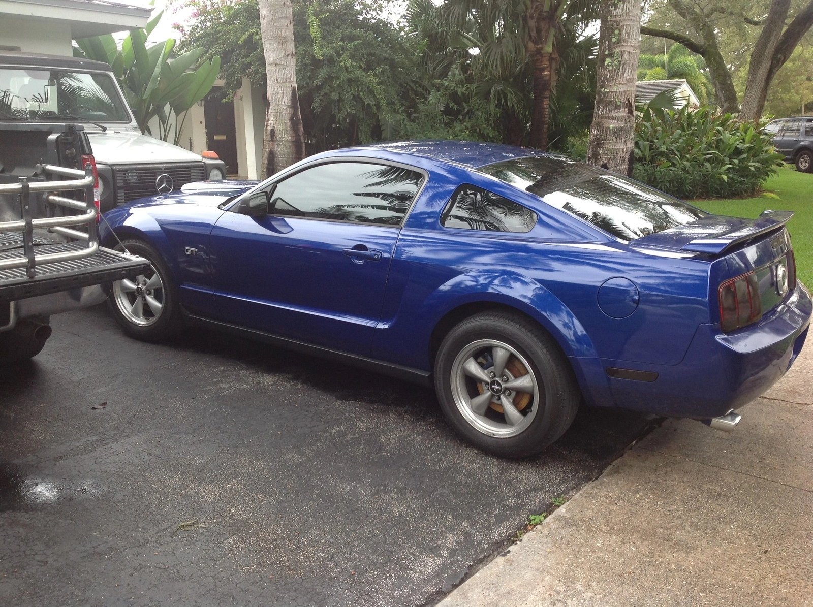

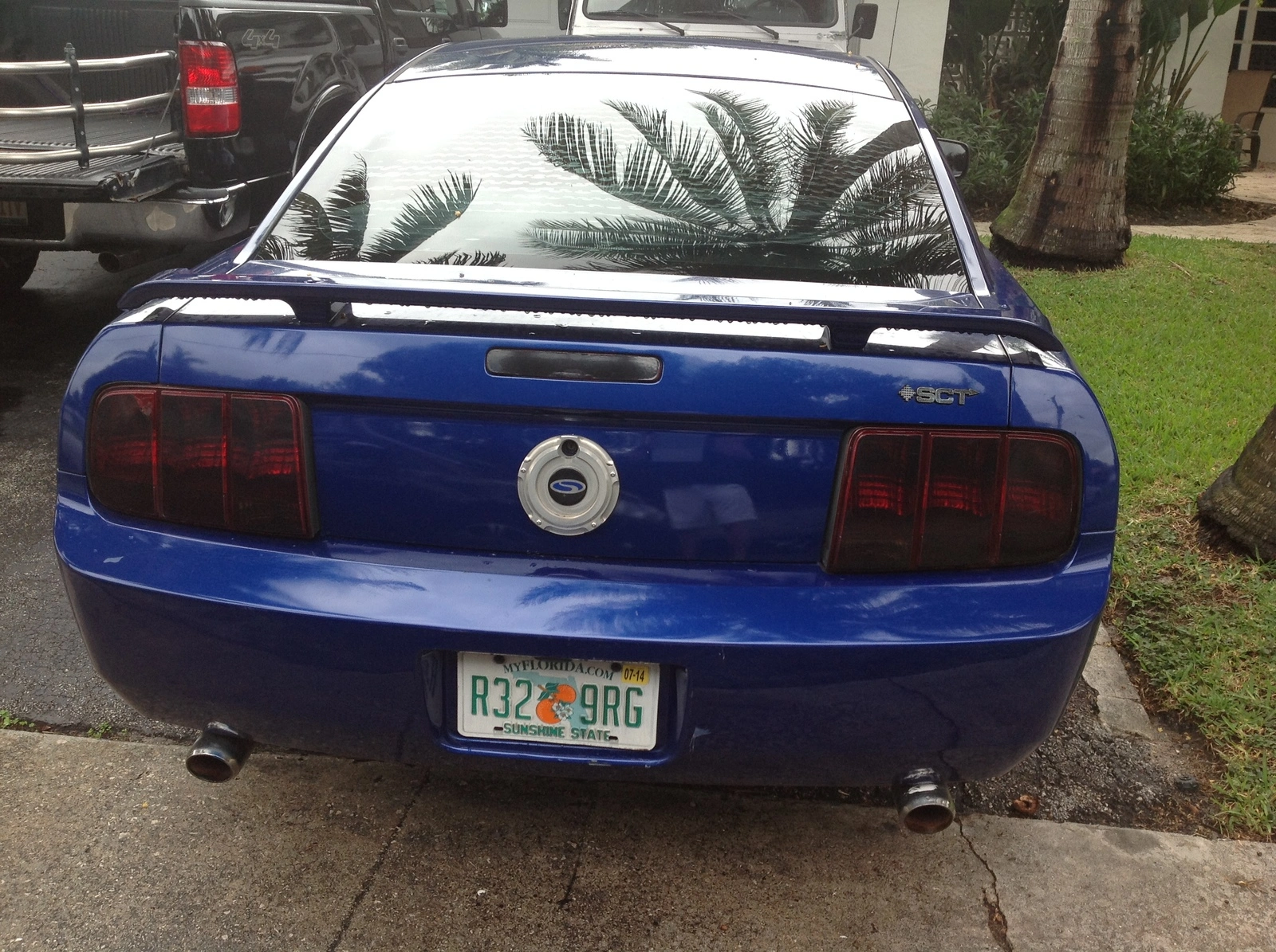

Hmmm interesting. Looks like he added aftermarket dual exhaust too - I know my '06 GT has indentations in the rear bumper where factory dual exhaust comes out, which this car doesn't have (not sure how the '05 came). There are also GT emblems on the fenders but the 4.0L was not an option with the GT model. If it were a true GT I think they would be asking for a lot more $ - unless it had a ton of miles on it. Alot going on here

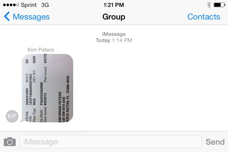

Thanks for jumping in again Dan. According to the VIN (see attached), it's a 4.0. I'm sure you know a boatload more than I do about these matters, so feel free to double check and let me know what you find. My friend is going by the owner's house tomorrow to get more details. My friend (Bruce), said he'd drive it here (about 9 hr drive) and fly back to FL. Bruce visits me often - so it's not unusual he'd make the gesture. I hadn't even noticed the GT emblems. I guess it's possible the "kid" that owned it was into emblems? All show - no go?

Yep, the T80 stands for standard coupe (as opposed to GT Coupe) and the N stands for 4.0LV6. Guess the kid was just trying to turn a standard V6 coupe into a GT clone. Not as uncommon as you would think. The GT would also have a more performance oriented suspension system. When you get a chance to look it over take a look underneath and see if there is any aftermarket looking suspension wise.

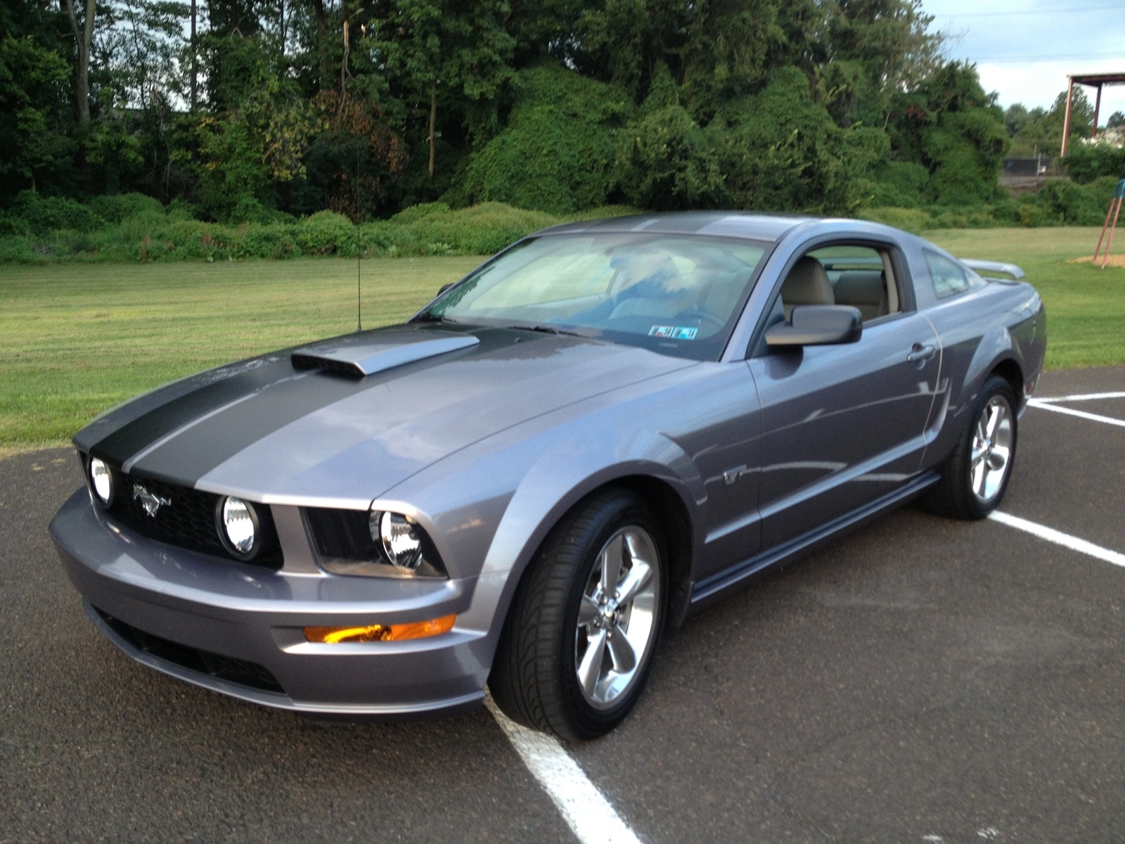

No I wouldn't be overly concerned with any mods as long as they are done right - there's all kind of stuff you can do to the V6 models, I just don't necessarily see the sense in it - but to each his own. The dual exhaust is a relatively simple switch - usually just a Y pipe behind the catalytic converter before the rear axle then two mufflers and tail pipes. Hard to believe he would have gone to the trouble of headers and new exhaust all the way back. That's only usually done if someone decides to supercharge (forced air induction) the motor. That would definitely be brought to any potential buyer's attention if it had been done. Here's my '93 LX and my '06 GT
