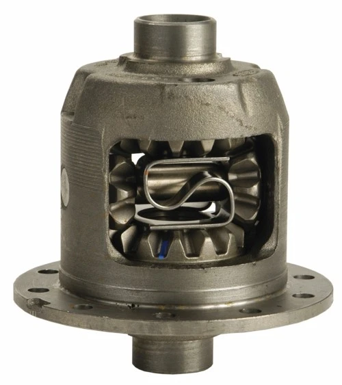

Traction lock is the limited slip/posi unit in your rear end. Excessively worn clutch disks in this unit can make a nice loud THUNK in the floor-board that sounds amazingly like a pop coming from the front end.
Lots of places have the rebuild kits (if this ends up being your problem) LRS, AM, CJPP... etc.
