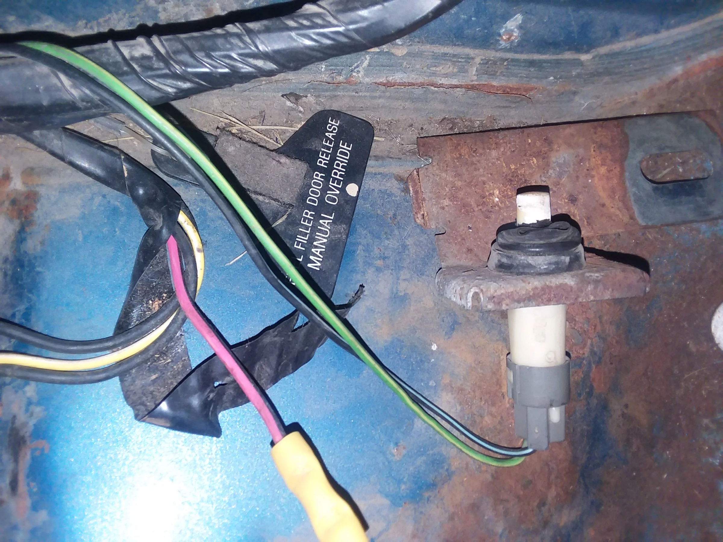

I'm attaching a picture of the cut off switch, there's a push button down by it too, isn't labeled and I have no clue what it goes to. I'm tearing it down this winter and changing some things, mostly the wiring. It doesn't look bad but stuffs hanging everywhere, I had to zip tie some up to keep from tearing them out when I get out of the car.

Oh ok lol. Someone told me to take the gas line off the carb and put it in a bottle, I did that and no gas came out. They said fuel pumps out then, but why will it start after it's sat for a while? I'm gonna try to get my hands on a set of jack stands tomorrow so I can get a good look at everything.
