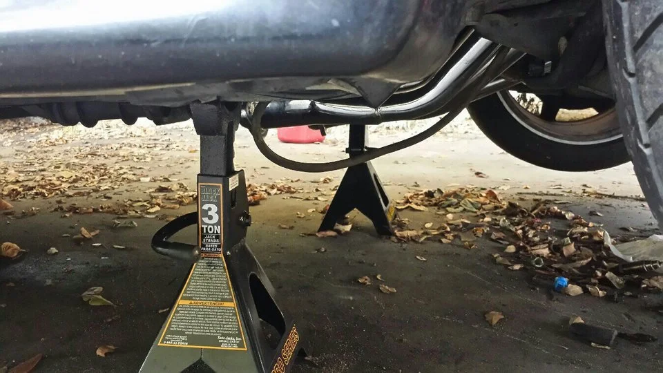

BBK LT's here. No clearance issues at all, anywhere. Close to the starter, but I've had no problems what so ever. I use Stage 8 locking header bolts with mine. Tighten from center, out. Drive, let cool overnight, repeat. Do this 3-times, then put on the locking clips and never look back. You'll want the 1" bolts.
no issues with clearance, maybe even better clearance than stock
