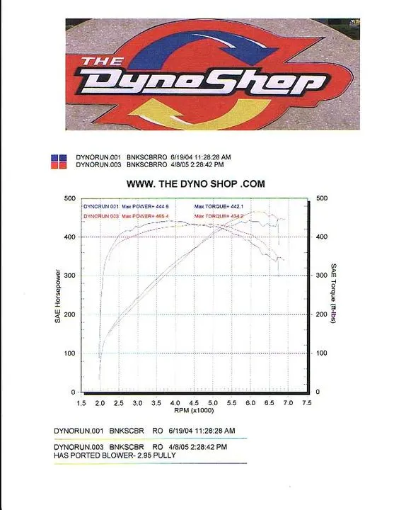

What UM said. I recently had my supercharger ported by Steig (TB and inlet still stock) and gained 40rwhp at the peak. My lower rpm hp/tq went down a bit due to the increased effeciency of the blower. I peaked at 480rwhp SAE but I'm also in California with crappy 91 octane so my tune is very conservative. Any place with 93 octane and a good tune, 500rwhp is definitely possible. The only change between the before and after was the Stieg port and here are the results:
[/IMG]

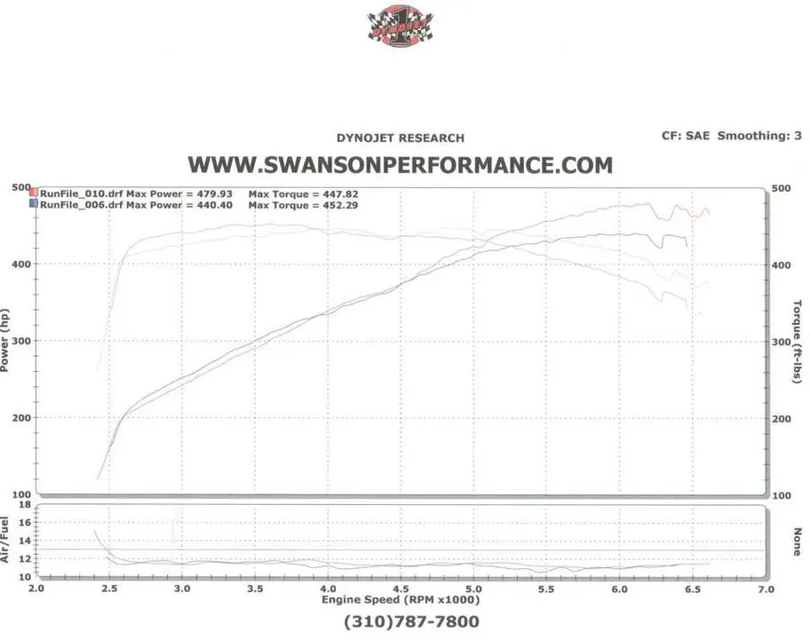

I'm now running the 2.8 pulley to make up for some of that low end loss. Top end was the same between the 2.8 and 2.93. Here is a dyno (different dyno shop with normally lower numbers) between the ported 2.8 and stock 2.93:
