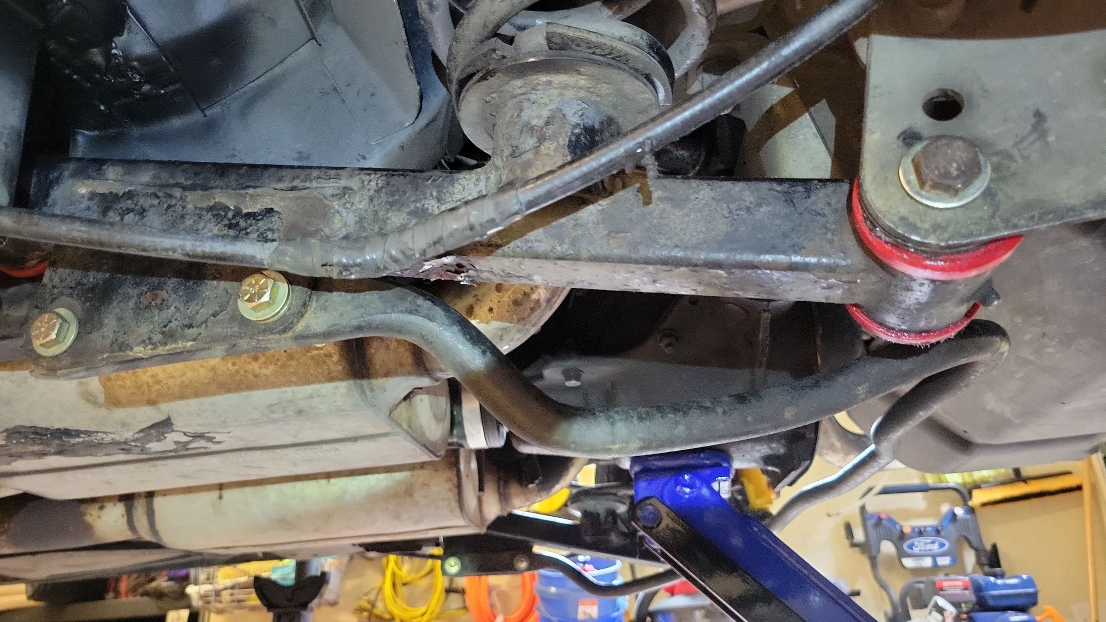

Anyways, the right lower control arms and my sway bar are back on where they're supposed to be.
On that one, he didn't want to put torn bushings back in. That's not awful, but I haven't gotten to the balance, or ignition-somehow-I-hope, issue, yet.

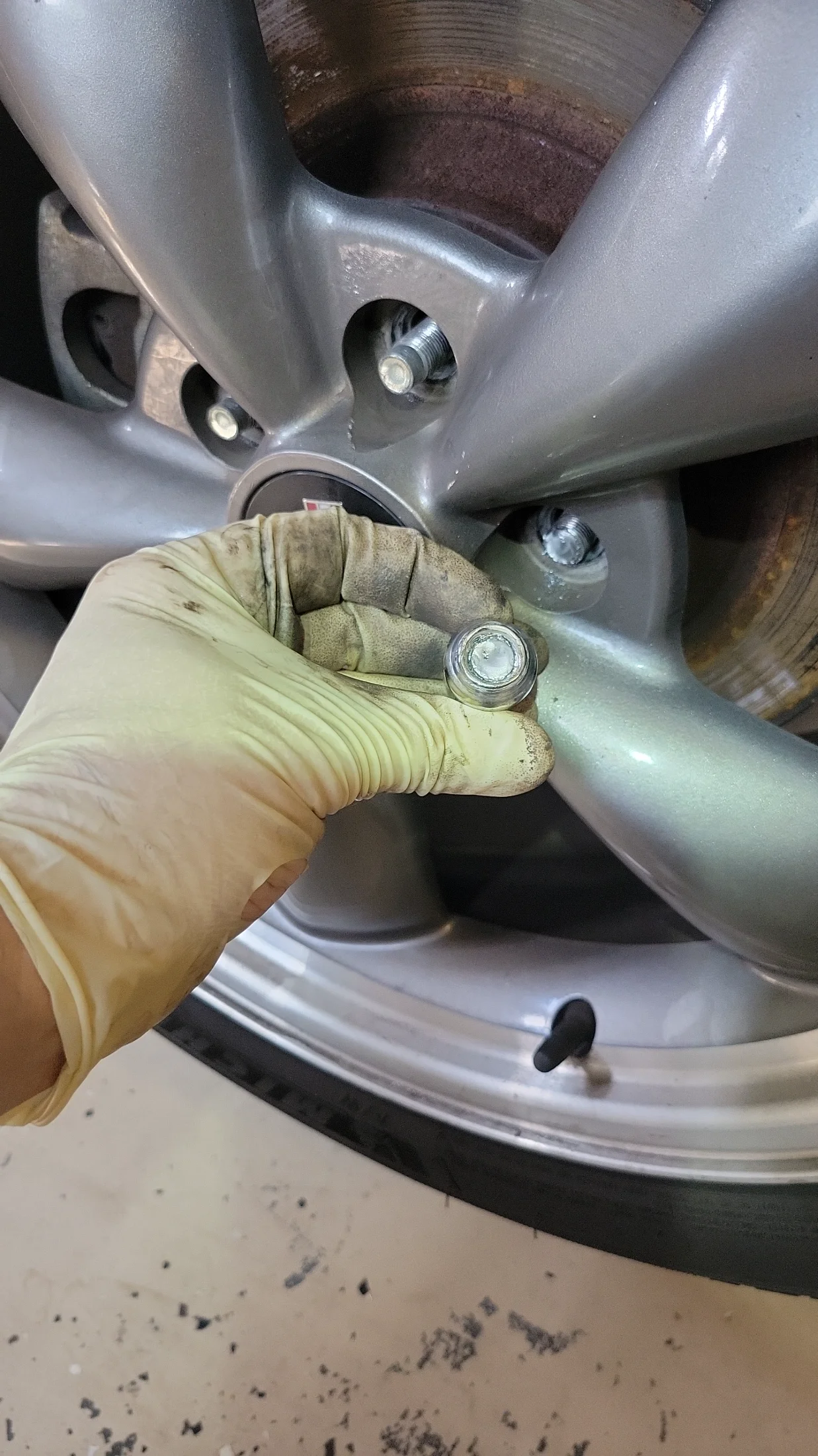

The experiment with the draglites is over. Even with a spacer that the guy who did the welding gave me for free, the shaved banjo bolt is still scraping, and I'm done with it. The other issue is that I don't understand this, but the lug nuts for the Welds bottom out before they firmly snug down the wheel, I guess maybe these are old and maybe they used to use different lug nuts. I'd have to have these machined, but I'm done with it. They're going to go back on Facebook marketplace.
On the bright side, the shank style lug nuts for 1/2" studs are radiused for 5/8" stud holes in the wheels, which allowed me to put my own 15 inch s71 wheels with 5/8 stud holes on it, and confirm that they'd be a fine fitment at 6.5" backspacing:
The 28x10.5Ws don't fit worth a damn up and down or on the outside, but that's not the point. I just needed to check the backspacing and whether they would clear the brakes, and they do. So I'll look on the marketplace or I'll just end up ordering the same wheels but with half inch stud holes.

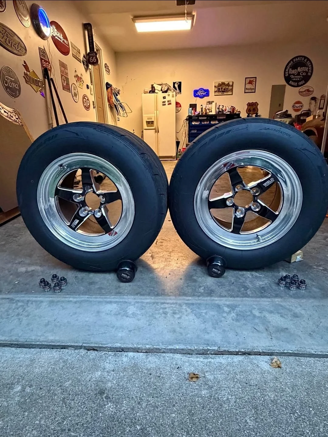

Well well... look what happened to pop up in my feed just down the road. I sold the old BMW winter tire set on the same trip that I picked these up.
They're basically new. The tires are too. They're 275 50 15 Nitto 555rIIs. Paid $1,200, but I think I'm going to get 300 or 400 back out of the tires. They'd be like $1,860 shipped in taxed new just for the wheels. So, although I do see some welds being sold for less on marketplace, I don't see a whole lot advertised that fit the fox body. I reckon they get snapped up pretty quickly.
