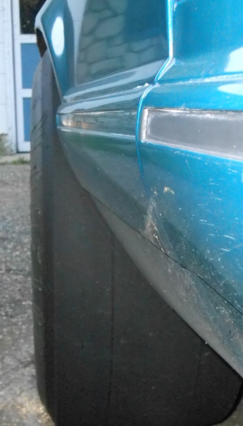

15x10 . 6.5 in bs -Is my guess being I got the wheels second hand from a friend . Wheel fits perfect . Clears by a mile everywhere you'd have a rubbing issue .

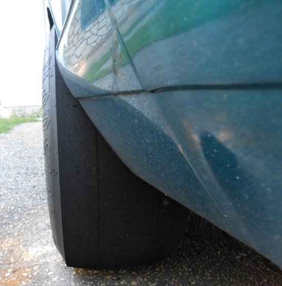

I have 15x10 6.5 b/s had to do a fair amount of hammer work to clear a 275/60 d/r. Can not run quad shock with 6.5 b/s.

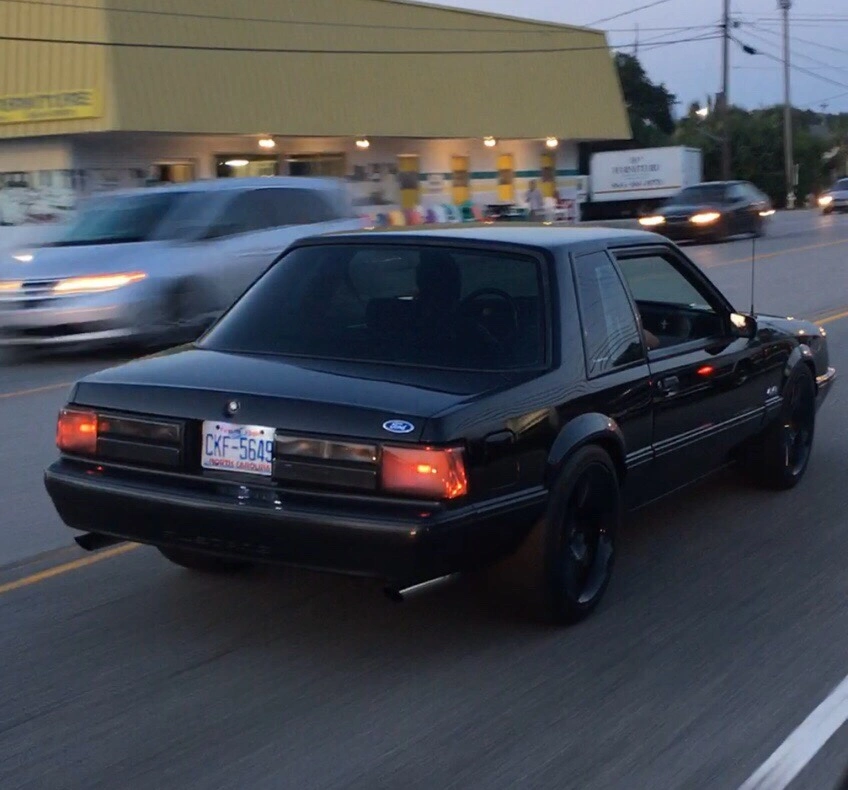

This is my 15x10 6.5 b/s Hoosier QTP 28X11.5. Guessing you have 5.5 b/s.
