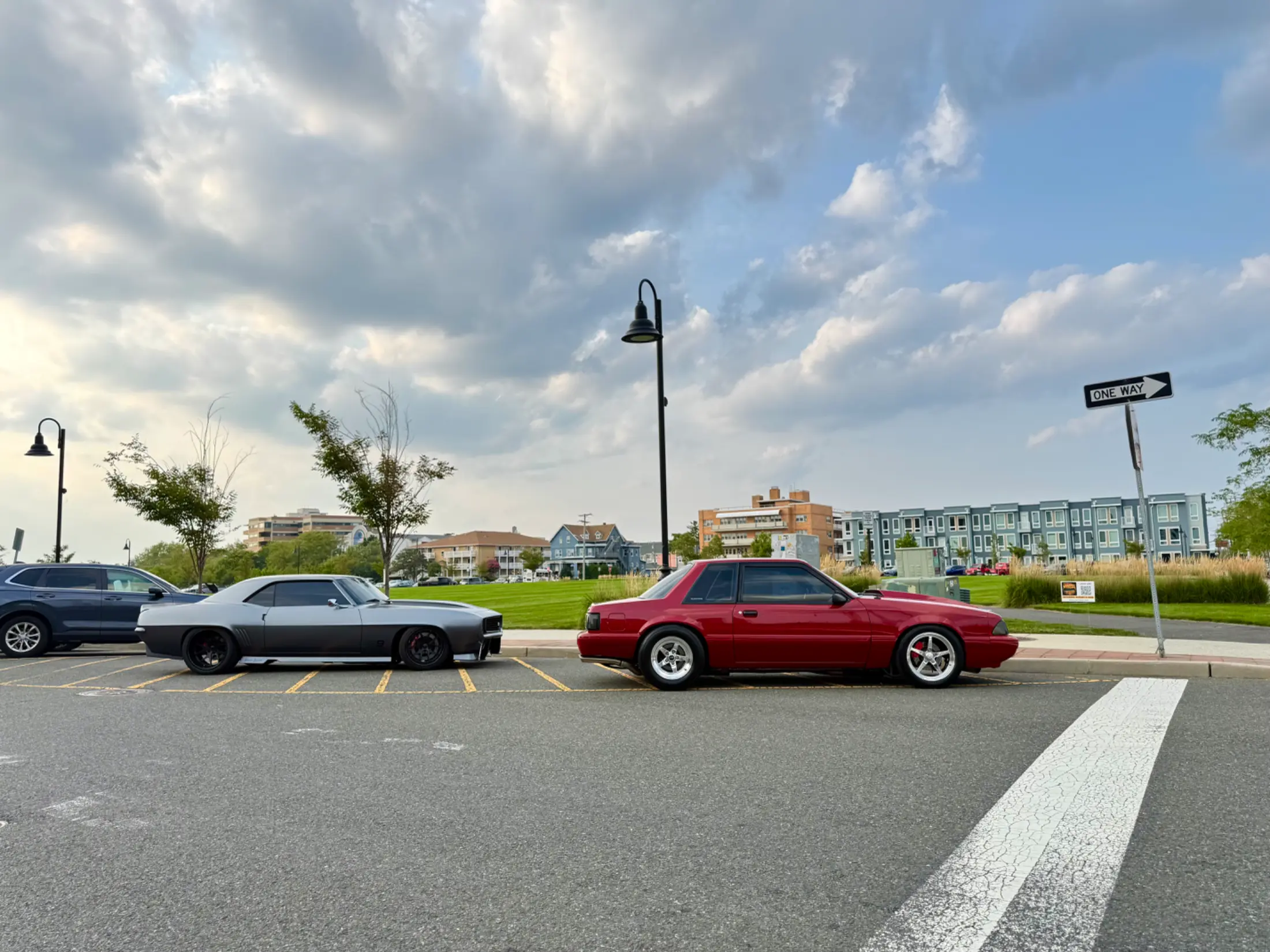

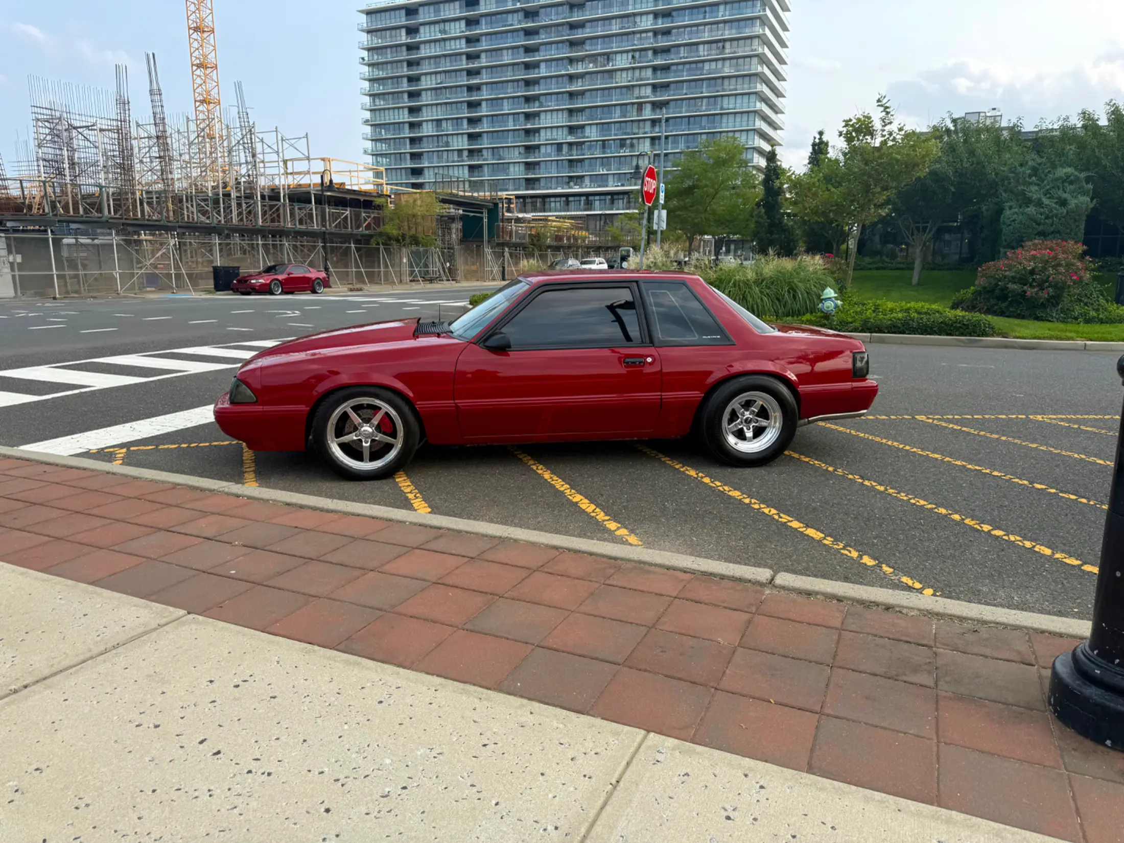

Just got my car back on the road after several years. Owned since 2011, blew it apart during Covid, then moved across the country. Redid a bunch due to CA smog, and just successfully smogged it this past week. Thankful to be driving it again!!
Bunch of little things to still do but so happy to be driving it again, even with the stock cam and 2.73’s (although I will be changing those).
