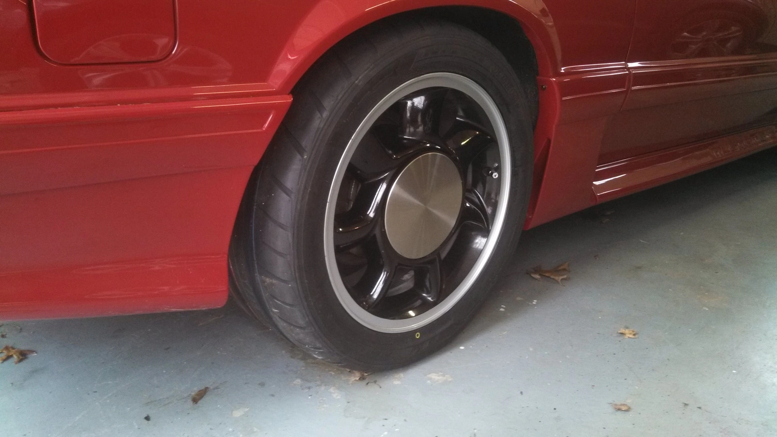

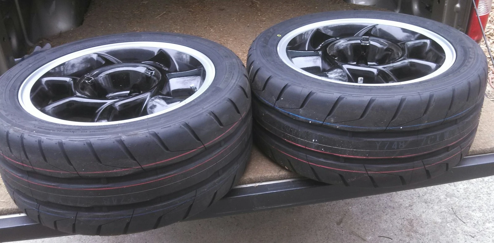

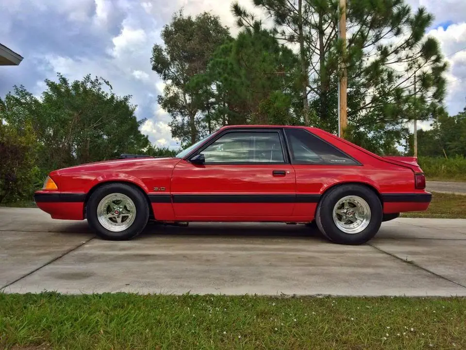

With the resent addition of HCI and 13lbs of boost I ran into traction problems. So, as of today the rear of my car now sits on these. Nitto NTo5r drag radials. "275/40-17's"
Geee I hope they help before I kill myself
They won't help unless you've done something else to suspension to make it launch well. The sticky tires will make breaking them loose more violent though.

TeamZ street beast UCA,LCA,rear springs and strange adj struts/shocks with some good front coil overs. Obviously Frame connectors and highly suggest MM c+c platesYeah I've got "learning" and alot of work to do in the launching department. This new found power is all new to me. My old tires had only around 8K miles on them but were 10 years old. They were hard, dry and needed replacing but at 230rwhp they seemed fine. Now at 480rwhp I had to replace them so drag radials were a no brainer.
I have tons of suspension and chassis upgrades to make the car handle but I now need to do some work to make it hook. I know a big part of my problem is the 3.73 gears. They made the car fun for years with 230rwhp, but now they might be a bit much!
But I can't help but think that if I could get the car to hook up with them it would be crazy fast.
Any tips or advice on upgrades you guys can give me for better traction? I'm all ears.
However these days this car is mainly a pretty weather Show/Cruise in car. I'm not looking to convert it to a drag racer but I do want it to hook better when I lay into it.
That car looks awesome! Looks FAST too!
I'm liking that wheel/tire combo more and more. Are those wheels a viable option to run on the street?
Thanks guys. The wheels are absolutely streetable. Holeshot will custom make your wheels with virtually any option. One option I chose with streetability in mind was to use 5/8" centers instead of the 1/2" centers. My thicker centers are supposed to hold up to street use (abuse) better than the thinner centers which are commonly used for drag racing.
