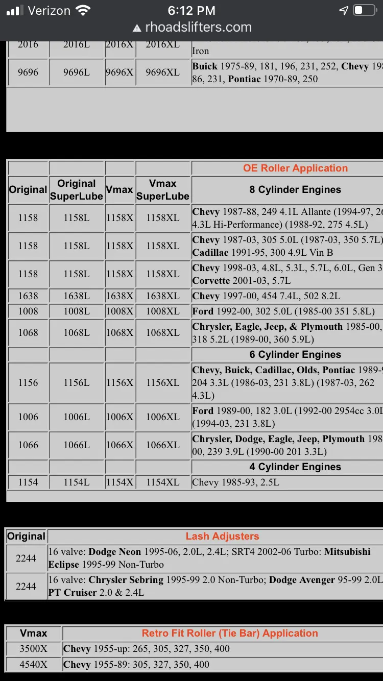

If you want idle quality and vacuum with a big cam, take your pick of Rhodes lifters. They work as advertised at idle and low rpm, at least 10 deg off the duration, up to 10” more vacuum, and from midrange on up, full lift and duration.
Interesting- was not aware of those. Very mixed reviews it seems- and I think the ticking noise would feel like a step backward and not the trade off I’m looking for. Keeping this in mind though, thanks.

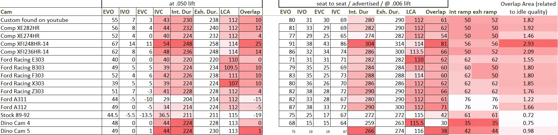

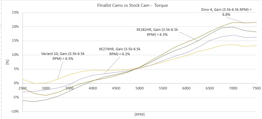

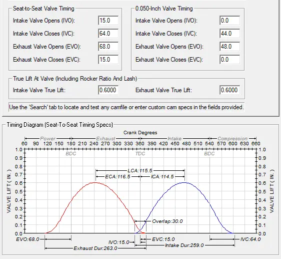

For those interested, I'm having some fun designing my own camshaft. Here's what I've got so far. In simulation at least, does about as well as some common comp cams and should idle much better (if I understand what determines idle quality correctly).
