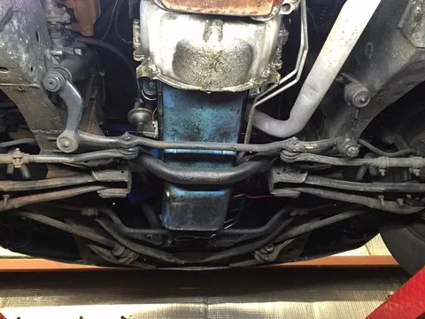

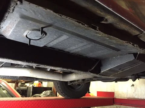

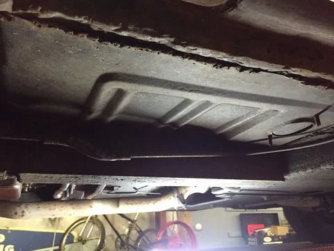

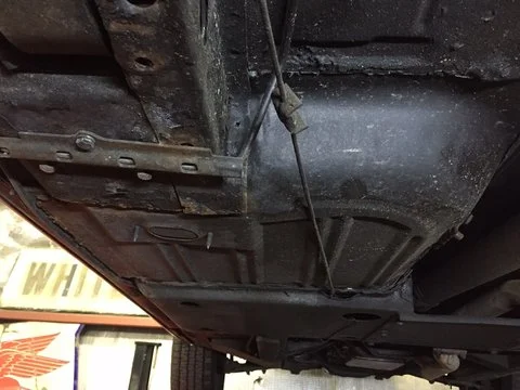

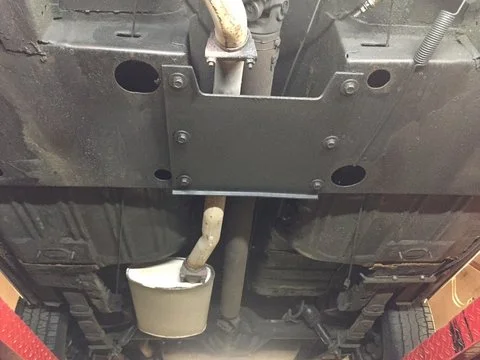

How's the undercarriage?

That floor separation is common on these convertibles. From the pics the rest looks solid? Your inner rockers look solid from the pics too which is rare (at least here in Ohio) If you can weld you can temp fix that floor from the inside by pulling up the carpet, chiseling off the factory seam sealer and making a patch bracket/panel. If solid enough you might even be able to wled that back together from the outside?
