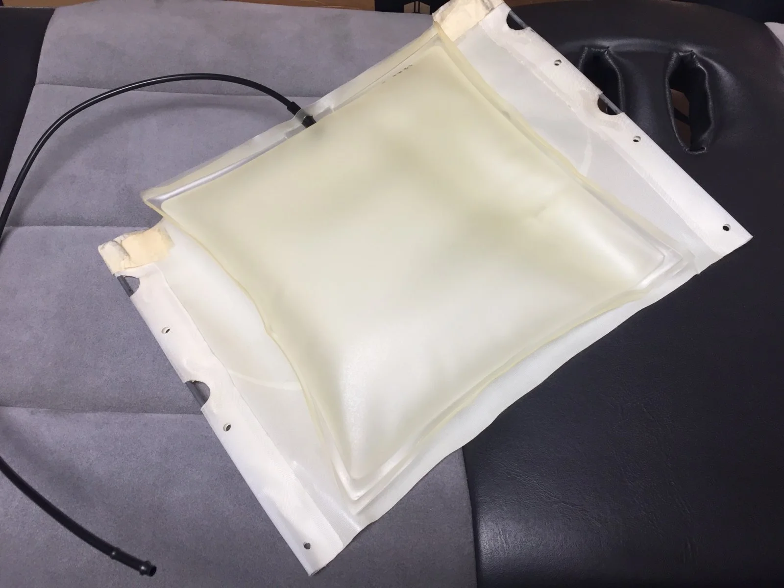

#1) Nope. Got a pic? Might be similar to the SN95 seat bags which can be possibly substituted.

Thus us what a 99-04 bag looks like
