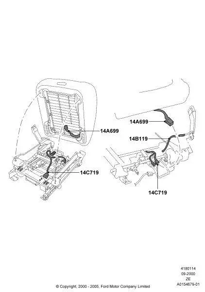

I'm looking for the connector that comes out of the carpet and plugs into the front driver seat plug to make the power adjustably work. Seats I'm using came out of a 03.
Does anybody know what the motorcraft part number for this electrical connector? I believe these are for 99-04 front seats only. Or a link to where you can purchase this? 4 pins square shaped.

Can't be sure what you're looking for is on this page but this is for an 03:
From Here: http://www.fordparts.com/Commerce/P...search=true&year=2003&make=Ford&model=Mustang
http://mustangpartstech.com/General_Information/2001FordMustangSeats.html
You can see the square four pin connector in that link. I need the female one coming from the carpet side. I want to make my own pigtail from a fox lumbar connector to the 99-04 power seat connector. I do not want to use barrel crimps. I saw on ebay on a guy sells a wire loom for 94-98 guys that install 99-04 seats in there cars. I contacted him to see if he could help me with that specific connector. No response yet.
