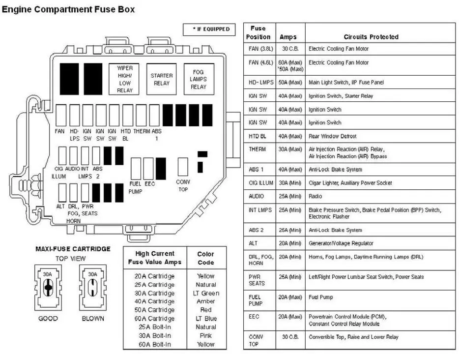

COramprat ...I can take it. I think. 20+ Year Stangneter Mar 2, 2003 8,474 1,463 223 Sea of Tranquility Apr 18, 2006 #1 Apr 18, 2006 #1 Anyone know where it is? My seat quit working and I can't figure out where the fuse is.
tomustang Psychotic Member Founding Member Jun 8, 2000 3,434 2 78 McLean Hospital Apr 18, 2006 #2 Apr 18, 2006 #2 4th from the bottom Attachments EngineFuseLocation98Mustang.webp 59.9 KB · Views: 17,147
four six Member Jan 19, 2006 506 2 18 Hobart, IN Apr 18, 2006 #3 Apr 18, 2006 #3 Its under the hood not under the dash
COramprat ...I can take it. I think. 20+ Year Stangneter Mar 2, 2003 8,474 1,463 223 Sea of Tranquility Apr 19, 2006 #4 Apr 19, 2006 #4 My fuse box looks nothing like that. Must have changed from 96 to 98... Edit...found it. Forgot I had the service manual CD... :O
