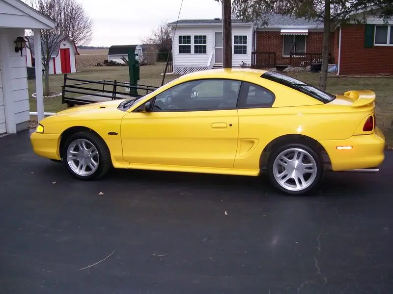

Hello all, new (to me) Mustang owner here. I have a question about the driver side power seat. It moves forward and back but not up or down. Any ideas what to look for to correct this? Is it a common problem? The car is great otherwise. Just waiting for some decent weather to drive it. Thanks in advance, JOHN
Here's a pic.
