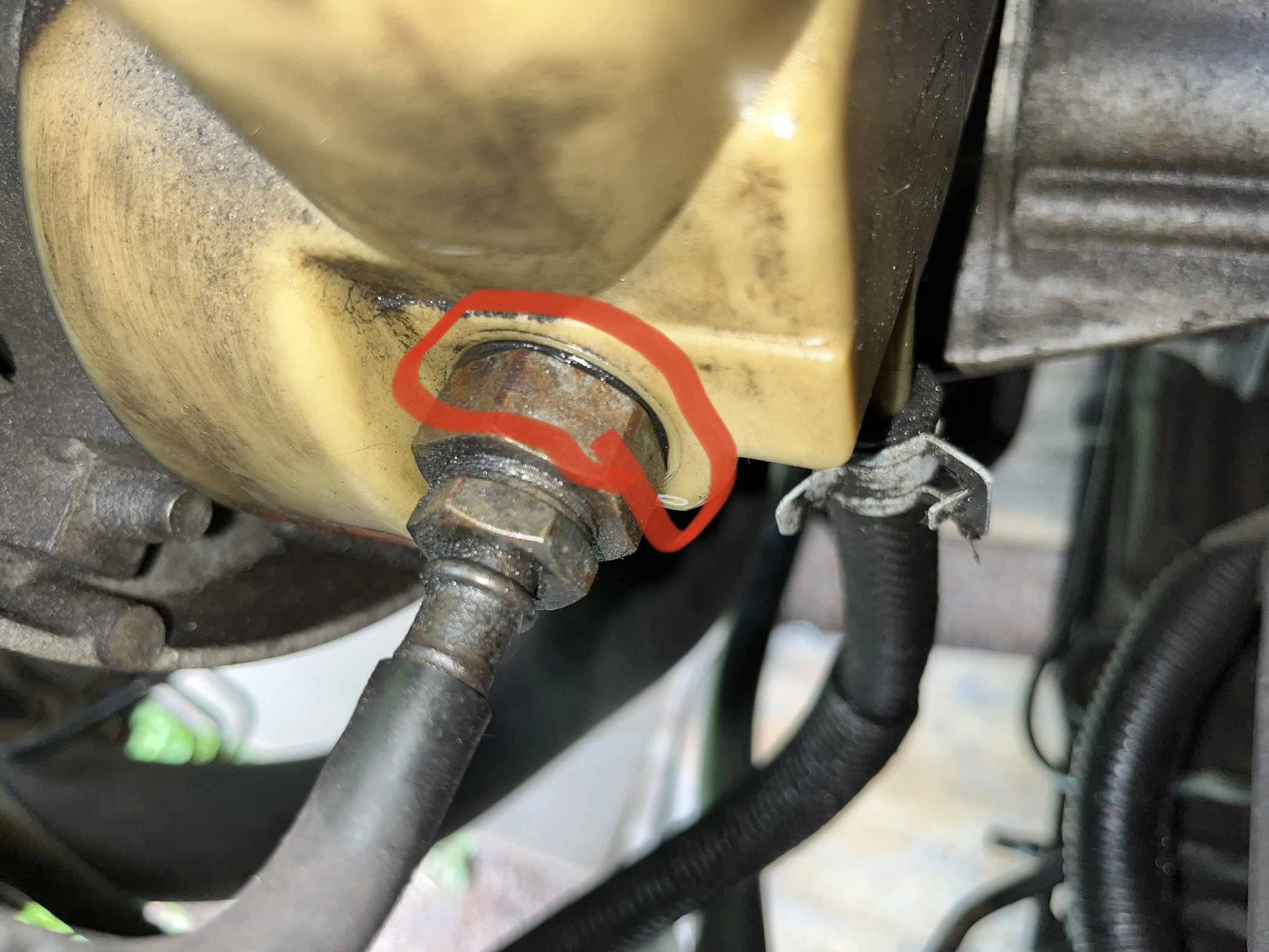

Hey guys !
I have a 2003 V6 that has a bad power steering fluid leak coming out where the bolt attaches to the reservar of the pump.
Is there a way to fix this by replacing a seal ? or do I need to replace the full pump ?
THanks !
Mine was leaking from this area too. The fix was to replace the O-ring on that high pressure line.
I bought the O-ring from the Ford dealership for $2. You can also try to tighten that large nut with a 15/16 wrench, but I DO NOT recommend it, as the reservoir plastic might be brittle and break.
I made a video of the repair in my early days of YouTube repairs (3 years ago), the video is Ok compared to my recent standards, but it gets the point across.
Thanks brotha ! I WAS ABLE TO FIND A PUMP REBUILD KIT WITH SOME NEW SEALS IN THEM ! WORKED GREAT !
