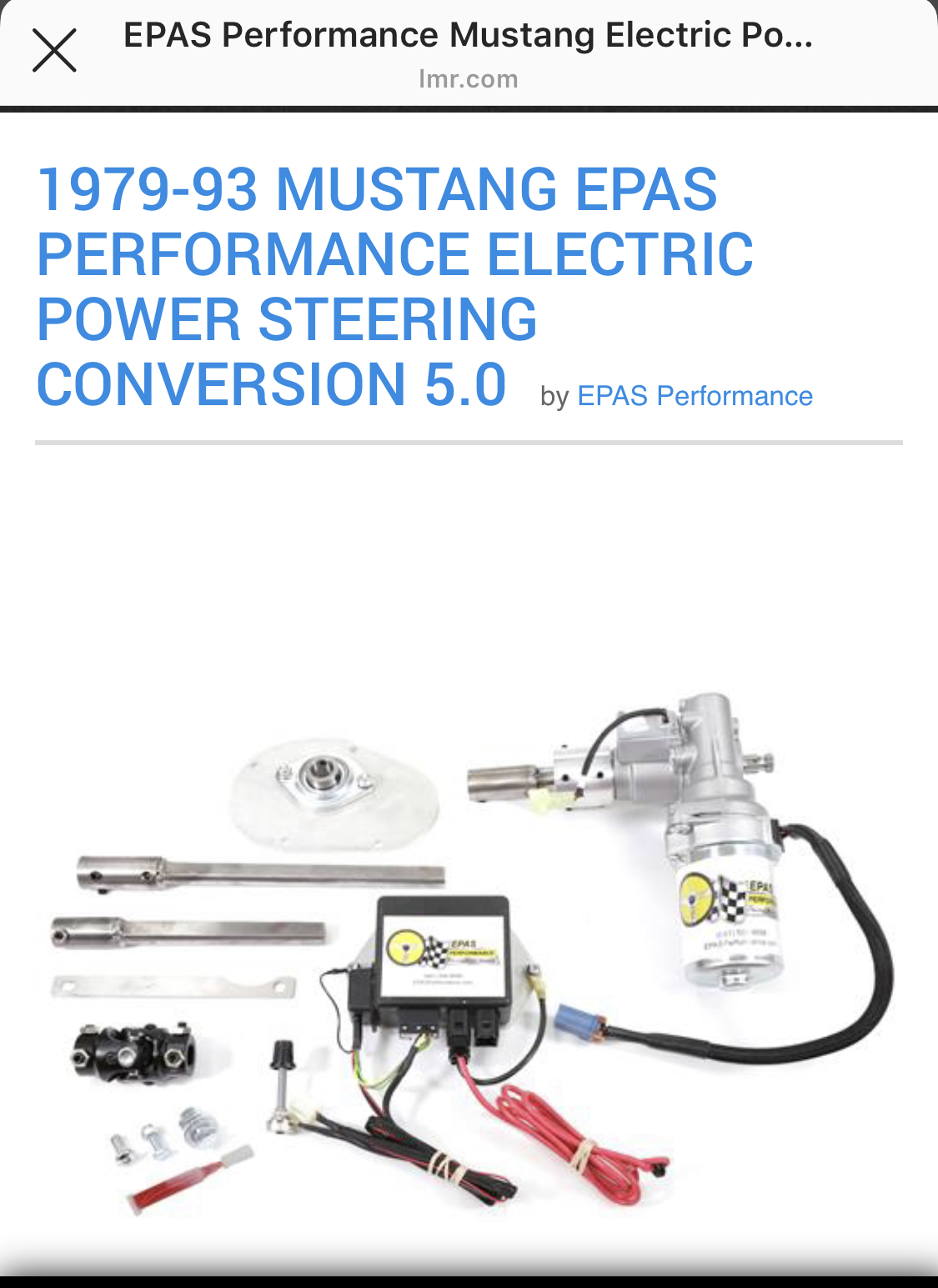

Since this was chatting about power steering thought I would ask what ppl think about this? Never seen till today but has anyone ever tried this or used one? Is it worth it? Besides not using the belt to drive it what other benefits are there?
You can probably vary the level of assist. I know in my Taurus with factory epas I can hook up the laptop and change the steering assist level.
Unsure if that kit can do it though, but a nice touch.
Really, it just allows you to delete the pump and go pure electric. Don't need much power whendrsg racing in a straight line, but then you can turn normally when street driving.
Unsure how it would hold up in autocross racing.
I'm personally not a fan. I'll stick with the pump. Cheaper and usually you have warning signs of the system failing.
