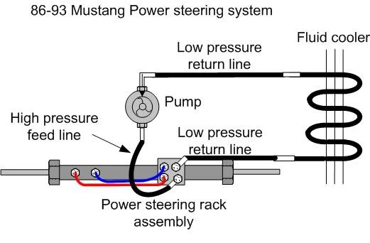

Rough diagram on how the lines route. 94-95 or even fox mustang lines are fairly cheap, but need to know what pump you are using and what rack?
I am actually using a power steering rack which is supplied by Factory Five. I'm pretty sure it is the same rack as in a 1985 to 93 mustang. The power steering pump is the factory pump that came with the car. In your diagram it does not show the reservoir which is separate from the power steering pump. In your diagram we're would the reservoir go? It is separate piece that is not attached to the pump but I'm sure you know that.

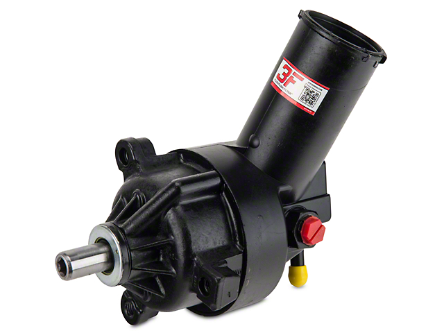

The older pumps feature a resevioir on the pump itself.
