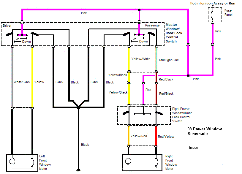

Power Window Wiring Diagrams
Fuse panel and circuit breaker layout
Diagrams courtesy of Tmoss & Stang&2birds
87-92 model cars power window wiring:
93 model cars power window wiring:
See the following website for some help from Tmoss (diagram designer) & Stang&2Birds (website host) for help on 88-95 wiring Mustang FAQ - Wiring & Engine Info Everyone should bookmark
Thank you for posting the wire diagrams, but I had searched and found them before I posted.
The issue is that there is power at the harness / mount that the window switches plug into, but the windows aren't moving. I can't imagine both window motors went out at the same time.
Do you have to have all 3 switches plugged into the harness / mount for the windows to work? Not sure if having them all plugged in completes the circuit or not??
