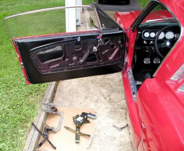

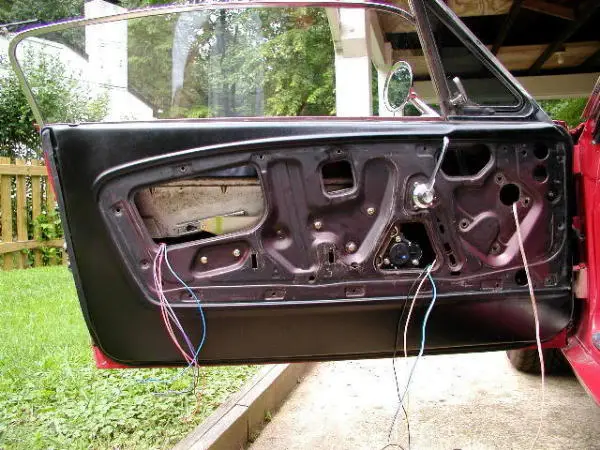

The power window kit installation is very straight forward. The hardest (most time consuming) part was running all of the electric wire.
Out with the old window regulator, in with the new. The new electric regulator just bolted right in. The install was very easy and the windows work great.
The hardest part was the wiring. Also, now that I don't need a window crank, I'm mounting a tweeter, for my component speakers, in the hole in my door panel.

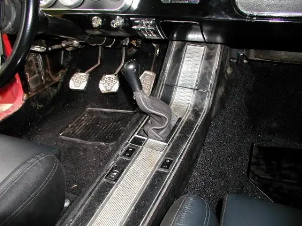

I mounted the switches in my console. They're tied into the gauge lighting circuit, so when I turn the lights on they illuminate.
Tim

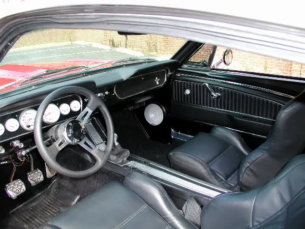

Also, I tied my power door locks into my car alarm system - Lock/Alarm and Unlock/Disarm alarm.
Tim
