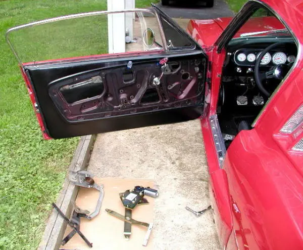

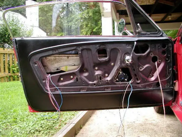

I've got power windows and power door locks and highly reccomend them both. I got both kits and the switches from A-1 Electric - http://a1electric.com/classics.htm - and was very pleased.
The power window kit installation is very straight forward. The hardest (most time consuming) part was running all of the electric wire.
Out with the old window regulator, in with the new. The new electric regulator just bolted right in. The install was very easy and the windows work great.
The hardest part was the wiring. Also, now that I don't need a window crank, I'm mounting a tweeter, for my component speakers, in the hole in my door panel.

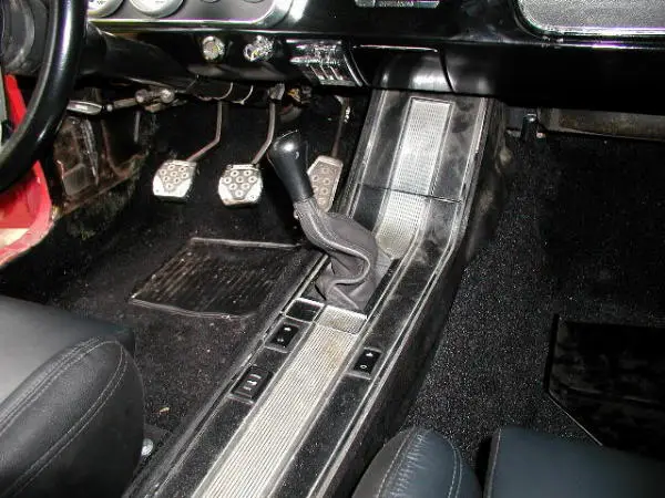

I mounted the switches in my console. They're tied into the gauge lighting circuit, so when I turn the lights on they illuminate.
Tim
Also, I tied my power door locks into my car alarm system - Lock/Alarm and Unlock/Disarm alarm.
Tim

That install looks pretty clean in the console, good work!

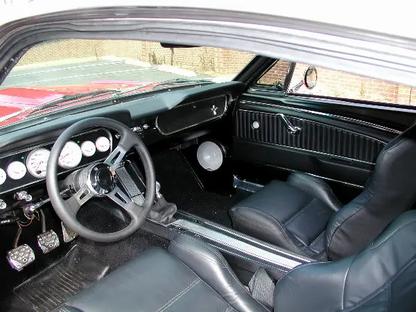

Tim, what speaker did you use in the footwells? I have the same panels, but can't find a speaker thin enough to fit w/o cutting metal behind the speaker. BTW...nice install on the window switches. How did you cut the metal? Dremel?
thanks
mike
Mike,
I used a Kenwood component speaker. I can't think of the model number (I'll check later to let you know). They have a much smaller magnet, but still sound great. I, also, used a spacer ring (http://www.crutchfield.com/S-UJ4PVAQzleG/cgi-bin/ProdView.asp?g=103200&I=003SG600DX) and cut and pounded the opening a little larger.
Tim

The difference in weight is neglegable, probably a couple of ounces (see the first picture of reference).
The wiring wasn't difficult, just time consuming.
- remove the seats, door sills, door panels, kick panels, carpet
- pull a 12 volt ignition hot power source to your switch location
- pull a light illumination circuit from the back of your gauge cluster (if you want to illuminate your switches)
- Run the switched power to each window regulator.
The trickiest part is drilling the holes in the doors and door jambs to route the wire - A 90* drill is very useful here.
