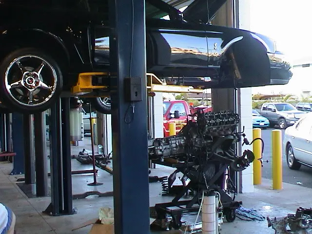

btw all teh techs at my work when working on mustangs pull from the bottom. i saw one use a fwd engine hanger to hold the motor as he dropped the k-member and then lower the car onto a pallet and then left the motorless car up in the air. took him longer to drain the coolant and oil than to pull the motor.

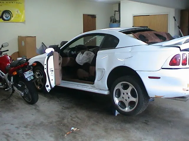

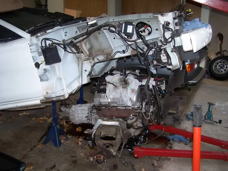

I pulled the motor out of my 98 from the top. The process really isn't difficult after looking back on it. I'll be reinstalling the motor from the bottom though now that there is room to actually lift the car and drop the entire suspension to do it that way.

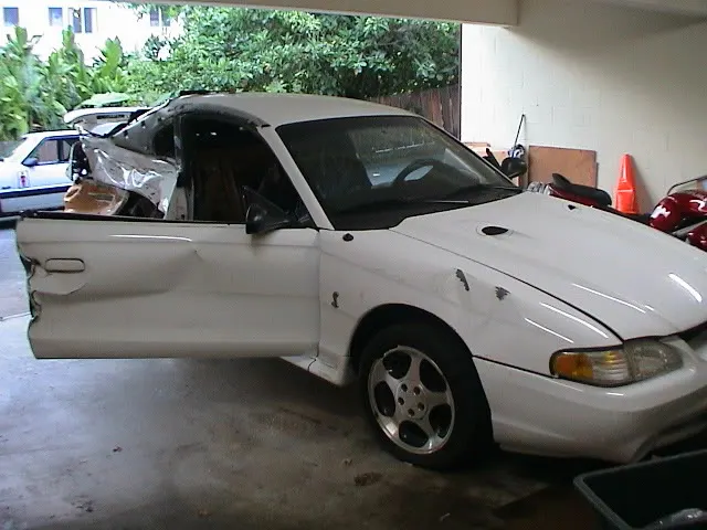

i HOPE that was a wrecked car being parted out
D
d90212
Jan 17, 2000
253
kailua, hawaii
Dec 20, 2009
#13
  • Dec 20, 2009
  • #13
yes it is...bought the entire car for $800

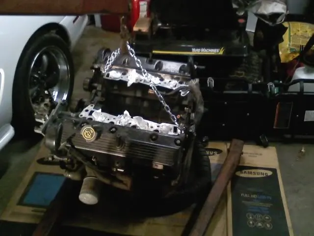

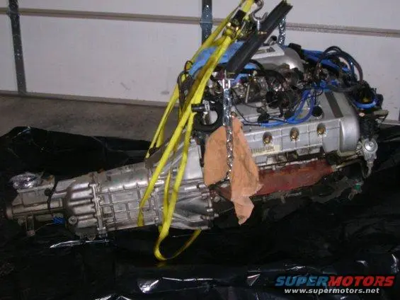

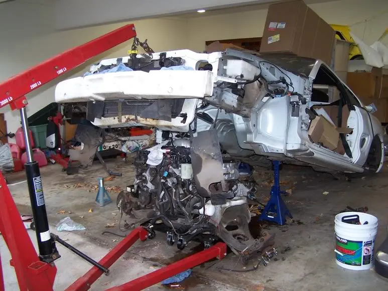

Question: if going in from above as a unit, how does everyone protect the plastic valve covers from being crushed/damaged by the chain?
There are the stupid expensive Ford brackets the extends the chain hooks eyes above the valve covers thus preventing damage. If the chains are connected directly to the heads, the the chain goes over the plastic valve covers. In my attempts, I was concerned about damaging the valve covers. Next, I had problems with the bolt interfering with the right hand hard AC lines.
I see on some of the pictures, a rag has been used to protect the valve covers from being scratched. However, isn't anyone concerned about the weight crushing the plastic valve covers?
Clearly the "from below" crowd have access to a lift. Is it safe to say that the non lift crowd is "from above" with an engine crane?

I would say that is the case for the majority. It's possible to lift the car high enough with jackstands and the such in the garage, however the task was much easier for me & the friend to just lift the engine from the top with the hoist. I also left the transmission IN the car with the help of a transmission jack& stands.

I built a custom bracket that you can see in my previous pics. Cheap and effective, and you can remove and install the whole complete engine with manifold on without crushing the valve covers. Also it uses 12mm bolts that are much stronger.
