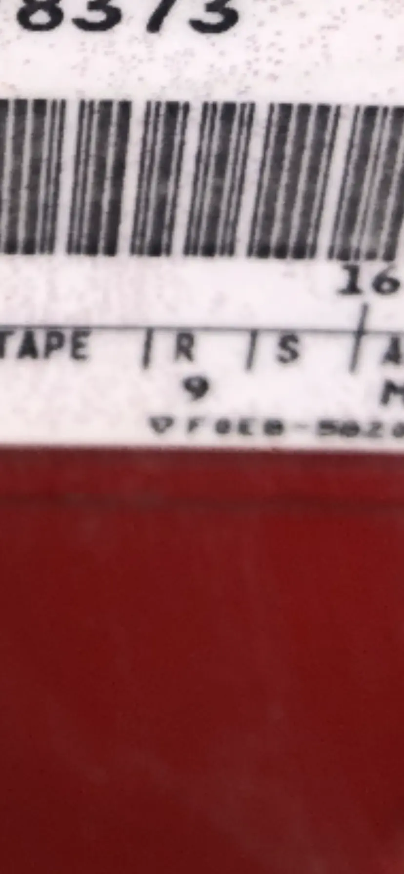

Look at the VIN sticker on your door. The column that says “R” will have a number or letter under it (see pic below. In this case it’s a 9).
That will indicate what radio came with the car. Google the code on your sticker to see what was factory.

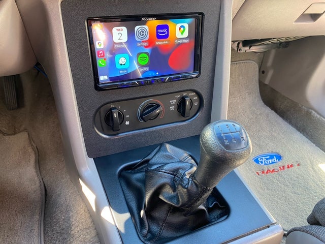

if you don’t mind modding the car up more, you can go with one of these relocation kits too.
I really like the double din setup but can’t bring myself to cut up a nice black dash to do it.
