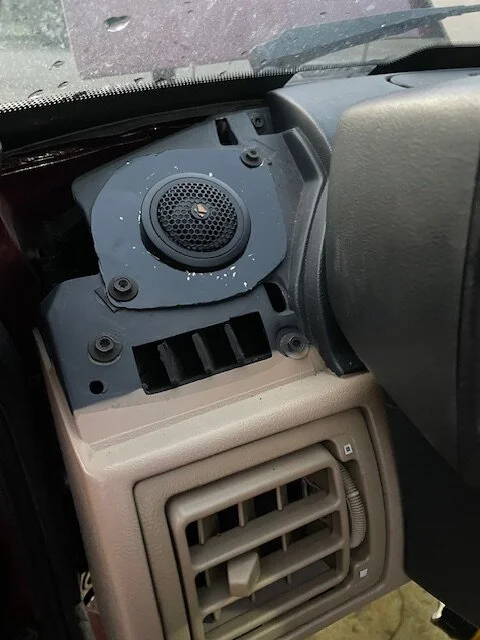

I should have said it before, but the front components are hooked to the door speaker connections with the tweeters powered by the door speakers along with RF crossovers. The dash speaker connections are not used. I have the tweeters mounted where the factory 3.5” speakers would have been using some custom, no drill mounts that I made. It’s definitively not the best for speaker staging, but I want to keep the Cobra stock-appearing along with no permanent modifications.

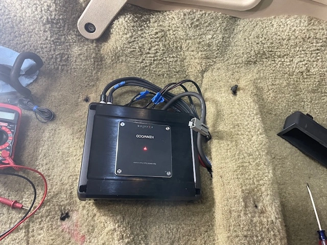

I've done stereo systems in 5 cars over the years, including my 89 vert, and I can tell you it's a challenge at best to get good sound out of an early 90s car without butchering it. My suggestion even though it would be more work is to just unplug all your factory wiring and run all new wires. You can run new speaker wire which will give you better sound, and just run power wires for the radio directly to t-taps on existing switched/constant power wires. As long as you don't have to cut any of the dash for the radio you choose, you can leave the old wiring in place and run a parallel system that can be completely removed without a trace. FYI a car this small doesn't really need an external amp for great sound as long as your head unit is good quality. I personally like Kenwood Excelon.

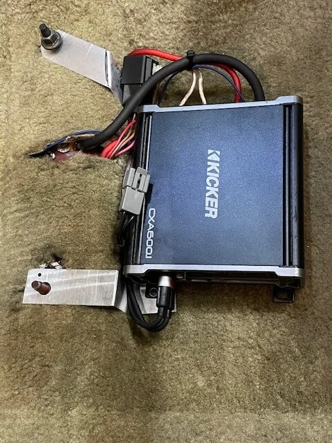

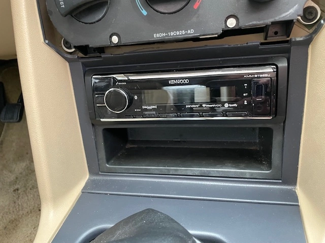

I put a system in my 89 GT that can be removed and nobody will know. Nothing was drilled and no wiring was cut, well other than the plug from the factory amp but it was dead anyway. I have kicker separates in the front. Mids in the doors with some killmat and the dash has the tweeters in the 3.5" location as mentioned above. Rear has some used kicker 5x7's in the factory location. I have two amps, one under each front seat. One powers all the speakers the other powers the 10" kicker sub I have in the hatch. I used the factory wiring with the appropriate metra wiring plugs harnesses for the radio with exception for the one for premium sound. I cut the mating connector off the amp and used that for the speakers instead of purchasing the metra one. It was dead anyway and I have another good working one so it was sacrificed. Speakers, got the metra adapters that plugged into the factory plugs. For a deck, I am using a used bluetooth Kenwood head unit that a friend gave me, no CD player so it is compact and light. Console is undrilled or modified. Other than the front separates the metra adapters, and misc wires, I had everything else kicking around. I am quite happy with the way it sounds. The only thing I am going to do, and I was looking at them earlier this evening, is to add a volume knob for the sub amp. I want to be able to adjust the amount of bass without having to go into the settings of the head unit or under the seat to the amp. I stream music 100% of the time and the gain difference from song to song seems to change drastically. Not sure where I will put it yet but I am thinking to hide it between the seat. Here are a couple pics that I had on my phone of my install.
