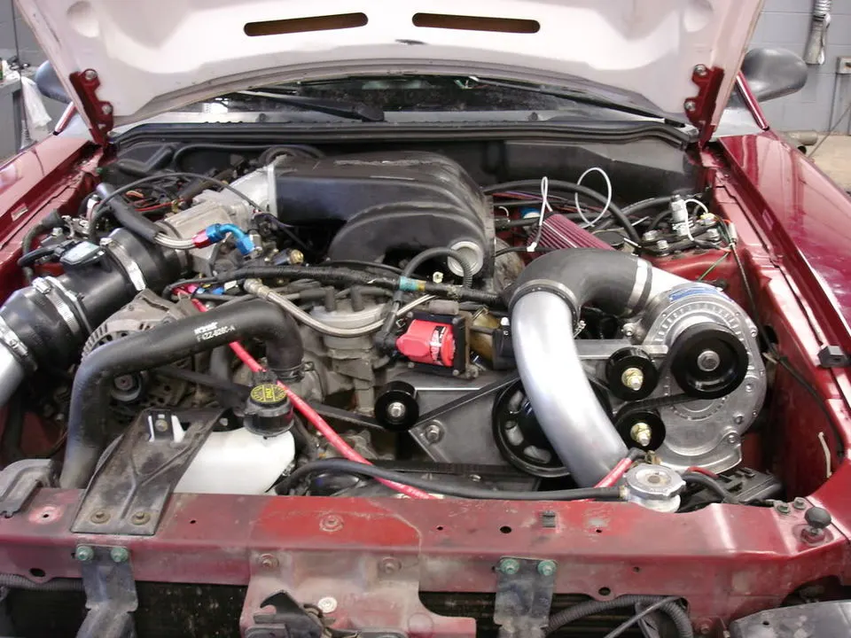

OK, ok, though I'm not sure why you want a picture of a beautiful supercharger surrounded by an ugly-ass engine bay.

Alright, you made me do it. Don't mind all the grease and grime, I see it as a form of rust protection. Also, most of that wiring is just temporary until I get things going well then i'll at least clean that up.

Well, considering I was half mentally retarded when I built the engine (I'm down to 1/4 retarded now) and I started out with a street upper on top of the R lower, the R-Series upper was a vast improvement in the higher RPM's. I'm sure that a the R-Series Box intake would have been even better, but its taller and this thing rubs the hood as it is.
By the way, Pokageek's engine bay will probably look fantastic. I put literally zero effort into how mine looked. I was building it on a timeline (only get so many breaks from school to go home) and didn't have a whole lot of extra time to polish things up and make them look nice.
