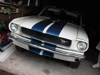

Hi, Pretty new to the boards and loooking for some guidance.
I'm rebuilding a fastback here in the Uk and it has an old battered 289 in it which I fancy selling and replacing with a nice 351.
I've seen their site and it's pretty impressive - anyone here have any experience of using them or buying a motor from them? :shrug:
I'd be looking at their 351 motor I should think.
They're in New Jersey if anyone knows them.
See www.mustang-engines.com
Shipping to the Uk for the crate motor would be about $1200 but still cheaper than buying one this side of the pond ...
Any help appreciated. :)
Another question while I'm here - I see all this talk of stroker engines - say a 347 from a 302 ...
Is it possible to 'stroke' a 289? And if so, what's the max capacity you can go to?
