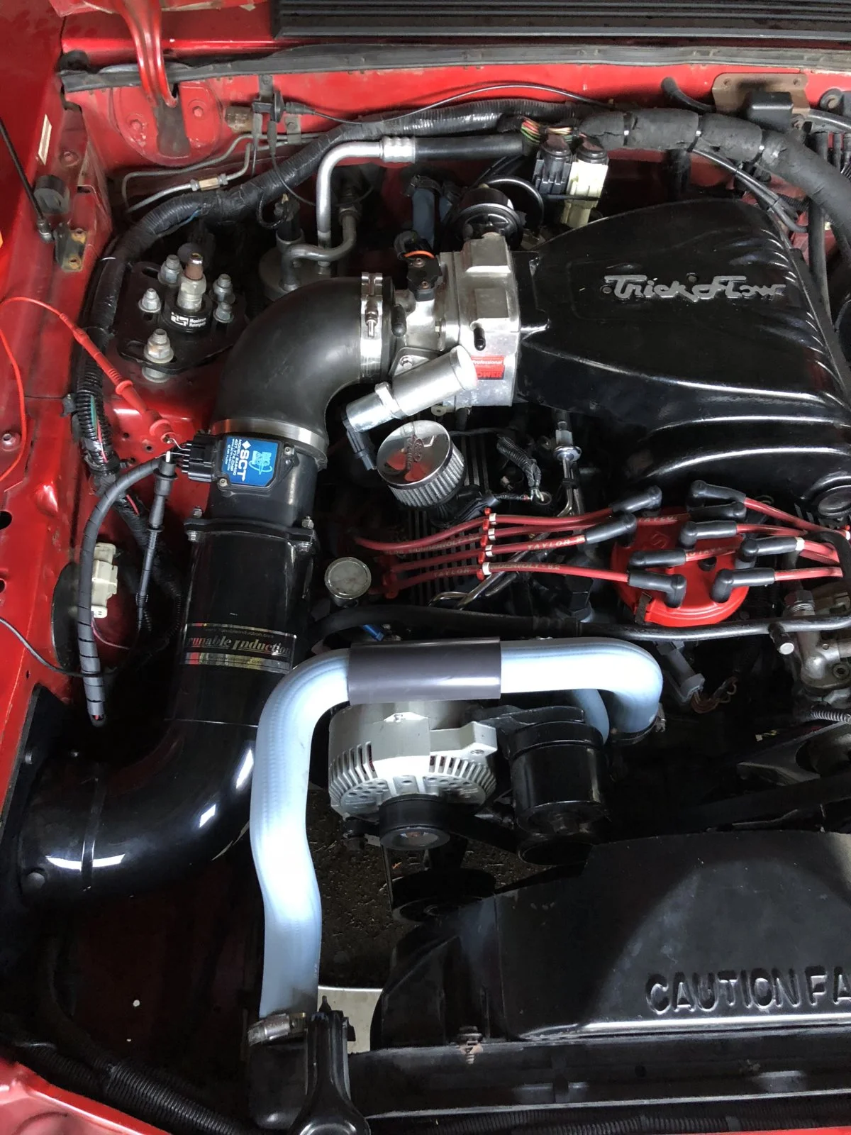

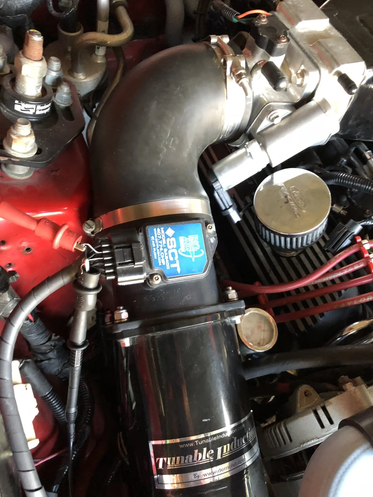

I do have a cone air filter but it’s up in the fender well and not in the engine compartment so that shouldn’t be an issue. I also can’t clock the MAF that im aware of the because the tube is bolted on in one location as opposed to held on by a clamp. Any other ideas you could think of?

A piece of screen wire in front of the MAF or the screen wire from a stock 55MM MAF might help. There is supposed to be at least 6" distance from a 90° bend and the MAF body.

@General karthief I attached a picture in this thread so you could see what I’m running but I have enough distance between the MAF and a bend. I can search for a screen. Would it be worth it to change to MAF wiring as well from the EEC to the MAF and buy a new MAF connector? What voltage should i be getting across C and D when uplugged from the MAF sensor? I was getting roughly 4.5 volts so I assume that is reference voltage?
