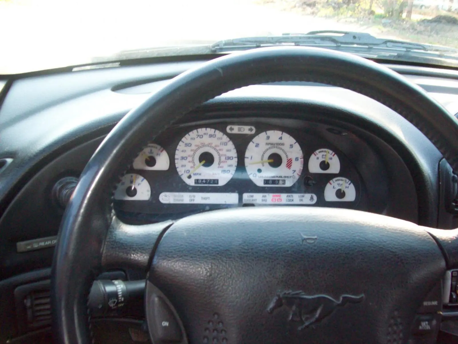

101_0659.webp glow gauges

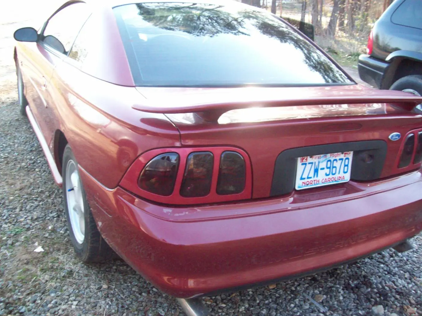

101_0658.webp smoked tail lights
o.k...so i can only upload two pics at a time without deleting the pics posted previous to these??? how does that work? I did it as an attachment and i can only do two at a time...am i doing this wrong because everybody else has several pics on their threads...whats the right way to do this??? help!:shrug:
