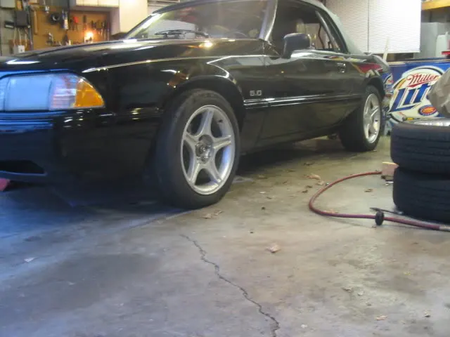

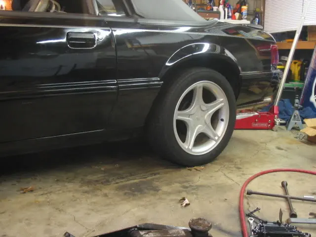

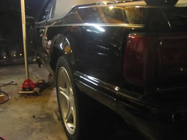

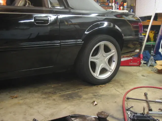

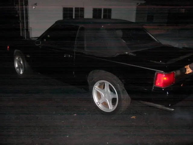

all done. i cant leave the drive way with it yet. *cries i wanna drive it so bad* gotta bleed the brakes. still air in the. peddle gose to the floor lol. thats no good. love the way it looks. going to mount the wheels tomm around 3:30 on the other two wheels then she'll be on the ground. after i bleed the brakes some more.

See? I told ya! lol. I know how you feel. I've been up at college and haven't been able to drive my car for the past month now. I've been stuck driving my girlfriends' I4 Galant that is slower than SNOT! I know its getting bad when I start thinking that her car is quick.
Try gravity bleeding Ryan. The way you do that is get the car up on jackstands, take off the wheels, remove the cover of the master cylinder and make sure it's full. Start at the right rear wheel and just open the bleeder screw until fluid runs out. Close it, go to the left rear, repeat. Right front, left front. It works, it's easy, and you don't need 2 people. Depending on how much air is in there, it might take a while for the fluid to start coming out, but it will work.

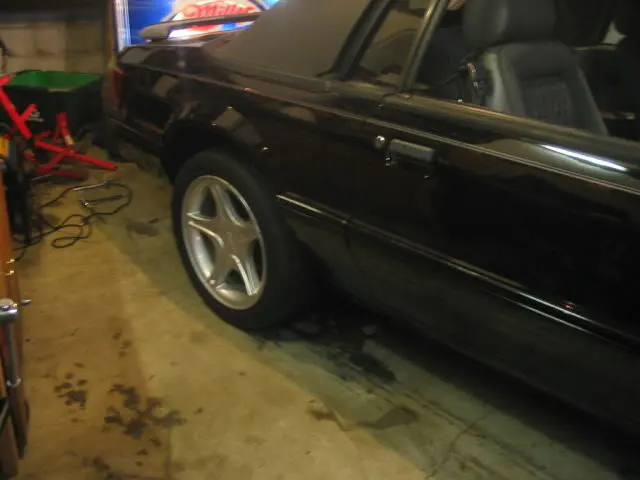

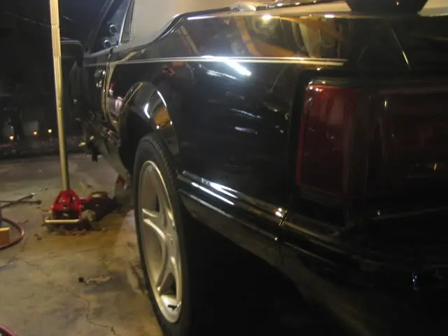

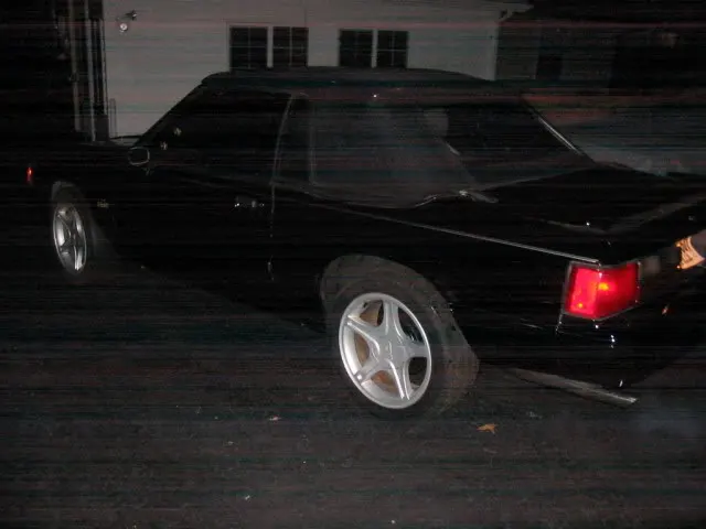

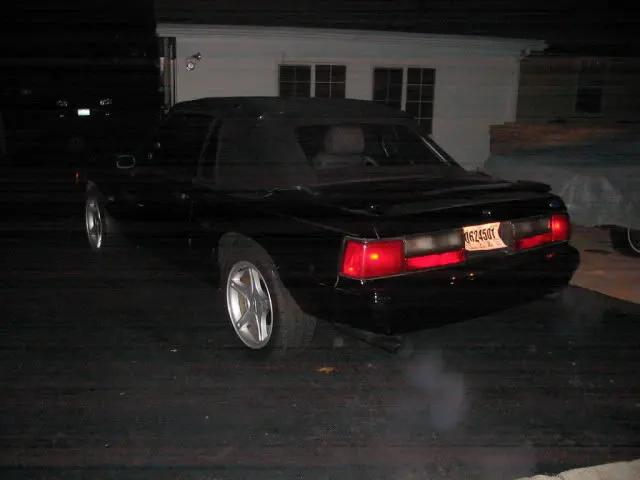

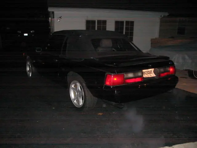

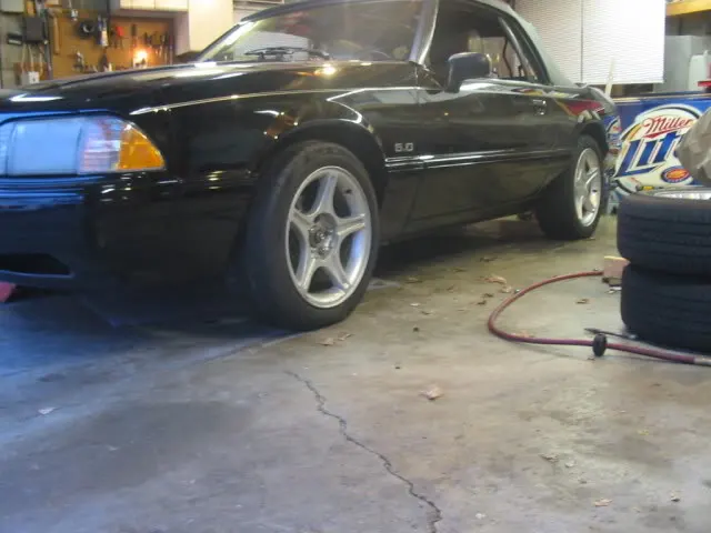

all done. brakes work. tried the posi out in the garage. it would spin both when i was blipping the gas...it was interesting..im ready to drive it on the road =]

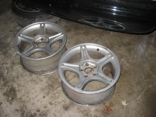

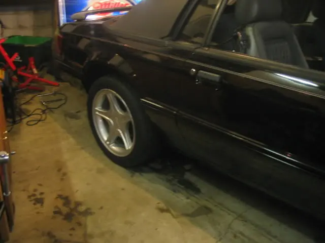

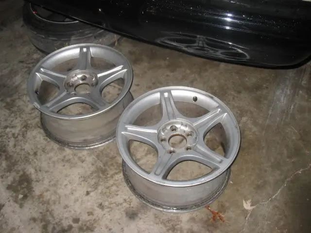

this winter my buddies dad is gonna powder coat the wheels for me. then the inside of the wheels will get painted black. that way you dont see the nasty rusty looking crap.
