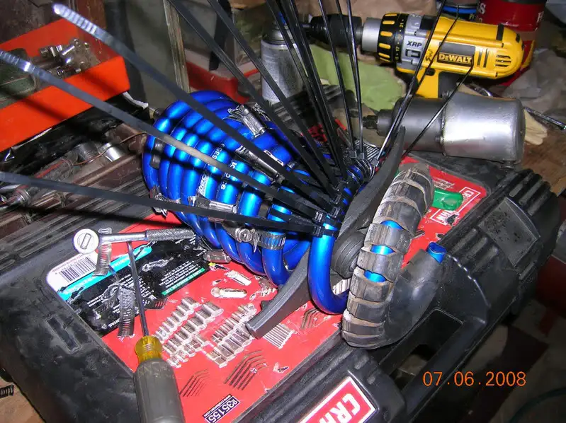

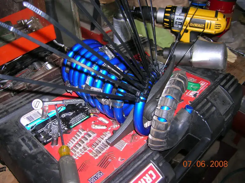

riceslayer302
Banned
Oct 3, 2006
CT
Nov 24, 2008
#278
  • Nov 24, 2008
  • #278
ryan218 said:
oh yeah. i was grabbing my cam to take pics of the blood running from my face. no you ******* i dont have pics of that ****.
lmao.
honestly though the hose clamp method is a great way to do it, i didnt even use hose clamps the first time used tiewraps
Pan-Duit of course
im just kidding, i used hose clamps and then cut them with a sawzall

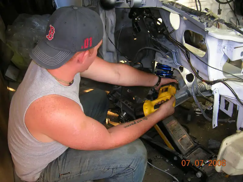

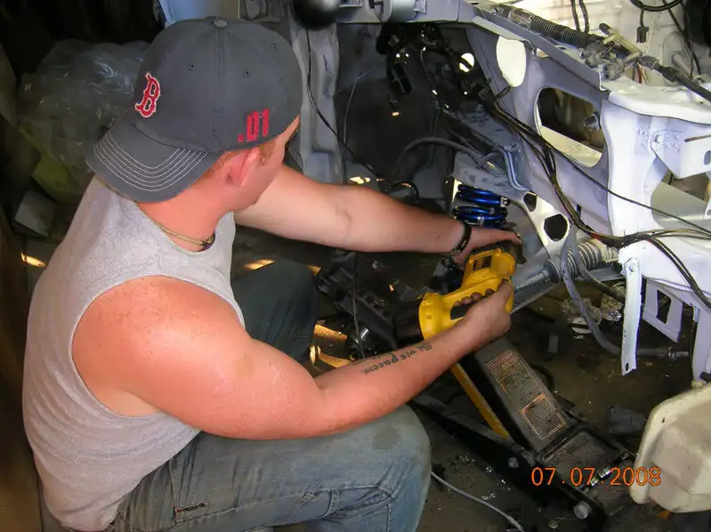

actually installing drag springs are really easy for me,i just drop the control arm and leave the strut connected,installed the spring angle it right and jack the control arm up while someone maneuvers the control arm in. Took me 15mins on each side.
