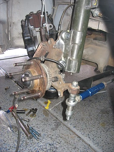

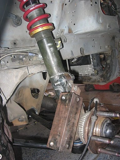

So, over the past year I've been gathering FR500C parts to install into my Fox as a track day toy.
I've put The FR500 calipers (Front) on already with some adaptor brackets on SN95 spindles and Cobra 13" rotors. I'm waiting on getting rotor hats for a decent price to update to the 14" rotors.
My latest aquisition is a full set of FR500C coilovers. They are the Dynamic suspension 3 way adjustable shocks/struts.

Right now I'm trying to find instructions on how to adjust the FR500C coilovers and I'm waiting for my springs.
Updates
I finally got the FR500C coilovers installed.
I ended up going with a big bar soft spring (BBSS) setup 450lb/in front springs 350lb/in rear with the stiffest steeda anti-swaybars, later these will be upgraded to adjustable swaybars.
FR500C brembo calipers mounted on cobra slotted rotors
