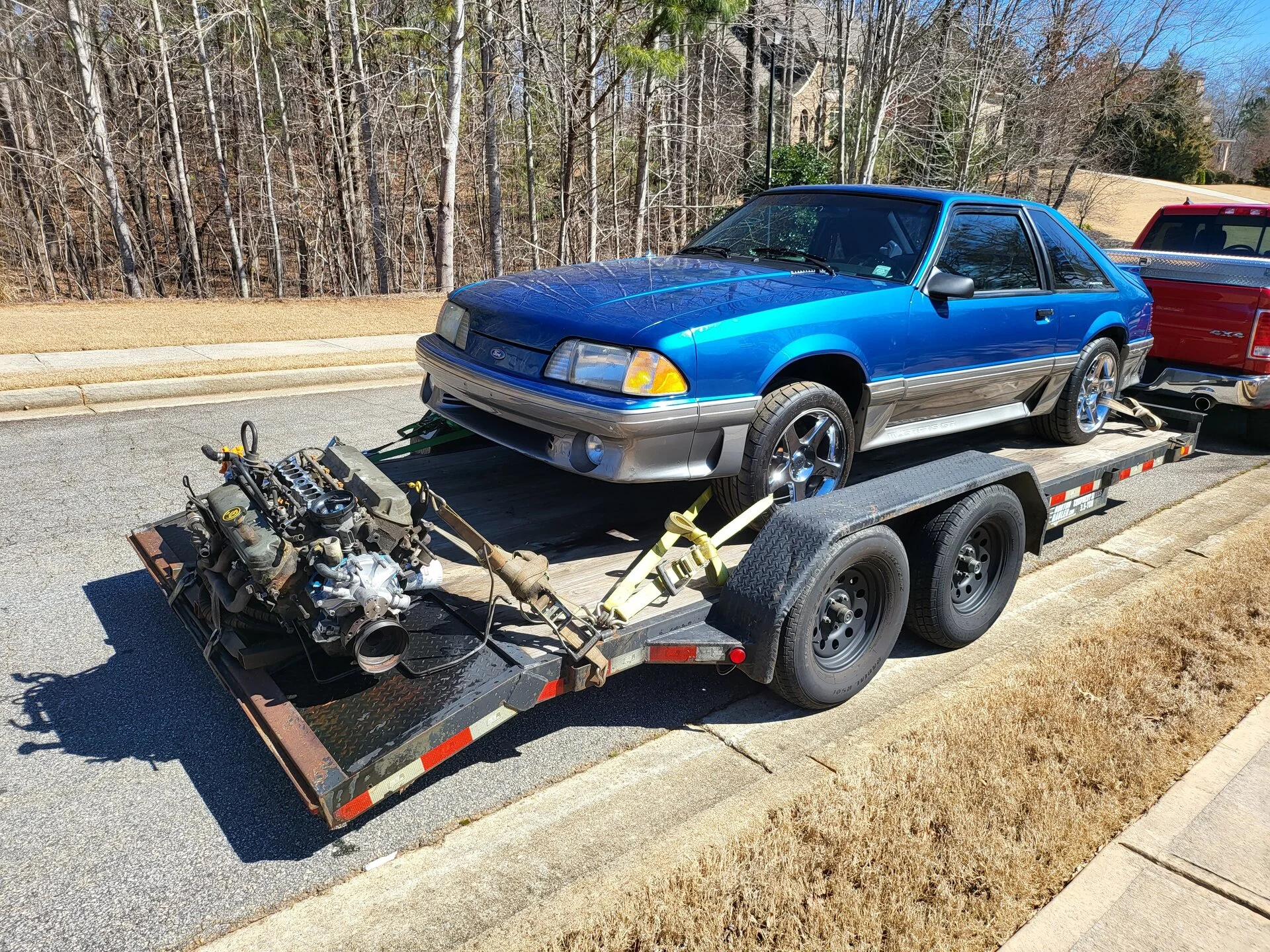

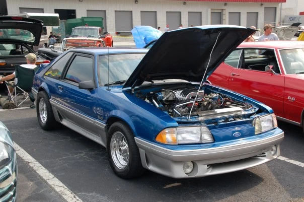

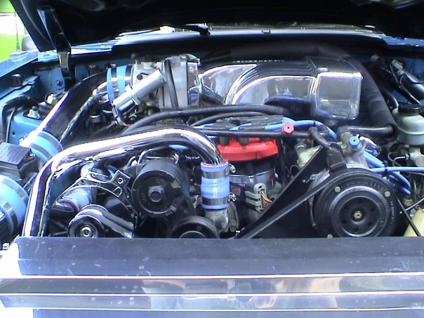

I have been a long time member of this site but I have been out of the modding game for the past 13 years or so. I previously had a 92 GT that was a bone stock AOD car that I built into a drag car. By the time I was done with it I had built the 347, converted AOD to TKO600, built rear end with 31 spline axles and c clip eliminators, etc..... Basically everything mechanical was replaced. I sold that car in 2008/2009 and had a 2012 GT and 2017 GT since then.
My old 1992 347
Fast forward to today and I have a 1990 GT aod car that is bone stock. I am trying to decide what direction I want to head with the engine build and was looking for some input. Back when I built my first fox no one was building 363s so that has me intrigued. The car will be a weekend toy/open track car. I want it to handle extremely well but I won't be competitively racing it so I don't need to focus on the engine build being strictly for road racing. With that in mind what are yalls thoughts on the engine builds below?
302 + procharger or turbo
347 + procharger or turbo
363 all motor high rpm build (similar to what bmr/summit did for a race team)
460 all motor
Coyote
7.3 Godzilla
I have not decided between 10R80 or T56 magnum. I prefer a manual but I want my father to be able to drive this car easily as he gets into his upper 70s/early 80s and he has nerve damage in his legs from a motorcycle accident.
My plan with the 302-460 motors would be to ditch the stock ecu and go to Holley's EFI system, their pro dash, and their traditional distributor replacement for coil on plug. Have there been any other big developments in the fox arena while I have been out of it?
New 1990 GT
Reactions: Potomus Pete

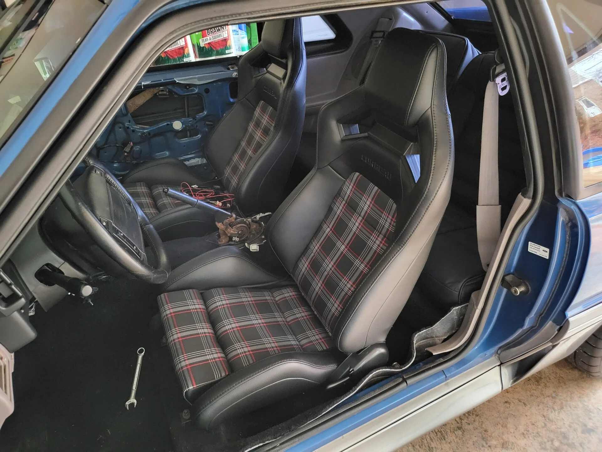

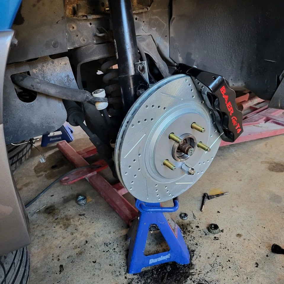

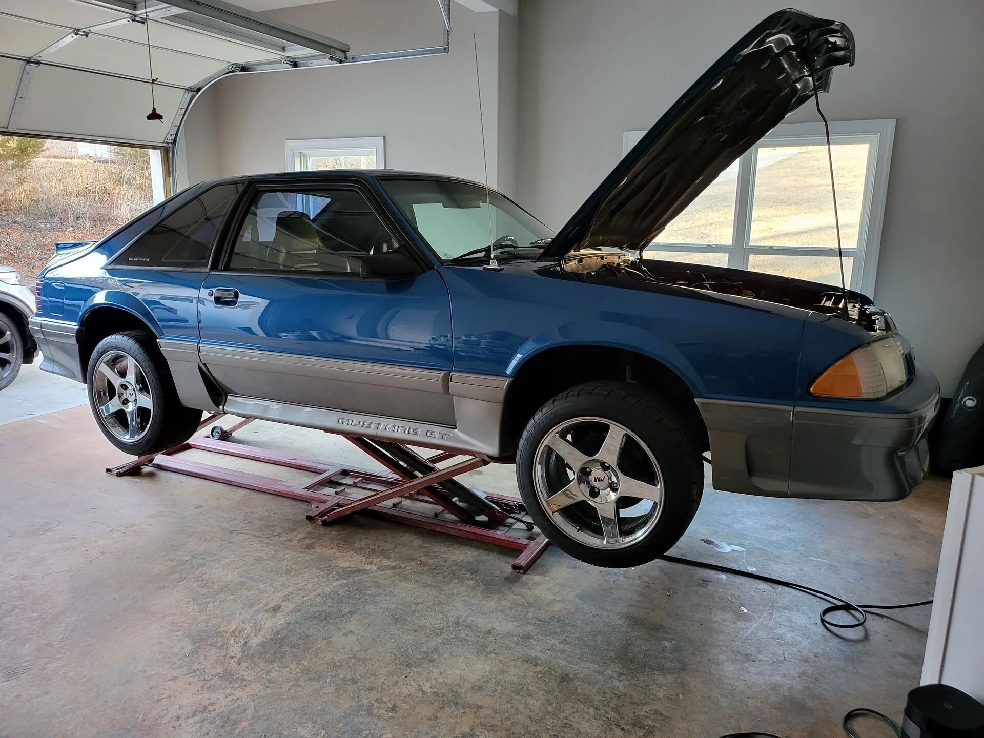

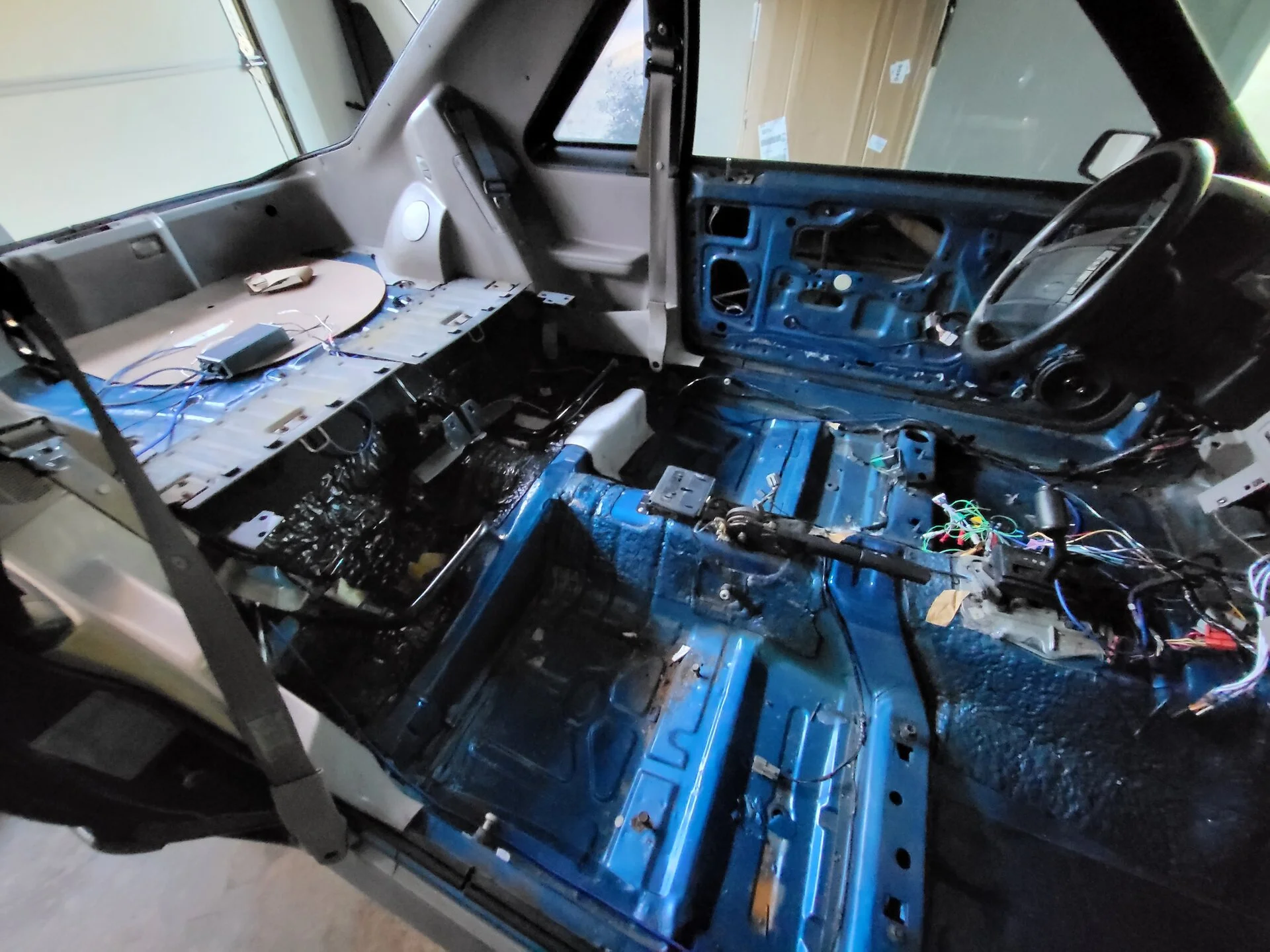

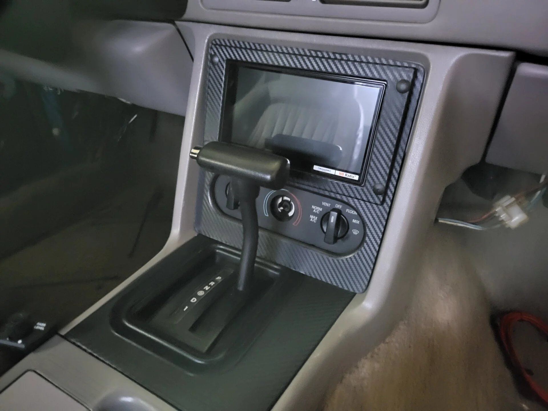

I have made a good bit of progress but at kind of a stand still until I can find a good local shop to fix my frame rail and strut tower rust. I have been working on converting the interior to black and upgrading the sound system.
I have ordered and am currently waiting on:
FRPP Z2363 eta june
Performance Automatic 4R70W eta may
Trickflow Track Heat intake manifold eta june
Holley 12" Pro Dash eta june
Maximum Motorsports k member, koni coil overs, torque arm, etc.. eta march/april
Parts on hand:
Holley Terminator X
Aeromotive A1000 fuel system
BBK 75mm tb
Cobra rear disc brakes
Corbeau RRX seats
200 amp gen 3 alternator
93 cobra master cylinder, booster, and brake lines
Parts I am considering:
On3 or pony down turbo kit
Front brakes and spindles
Wheels
Chicane23 2" fender
cervinis 2.5" cowl hood
Radiator/electric fans
What rear end and gears
Reactions: Mustang5L5, Mstng93SSP, Potomus Pete and 2 others

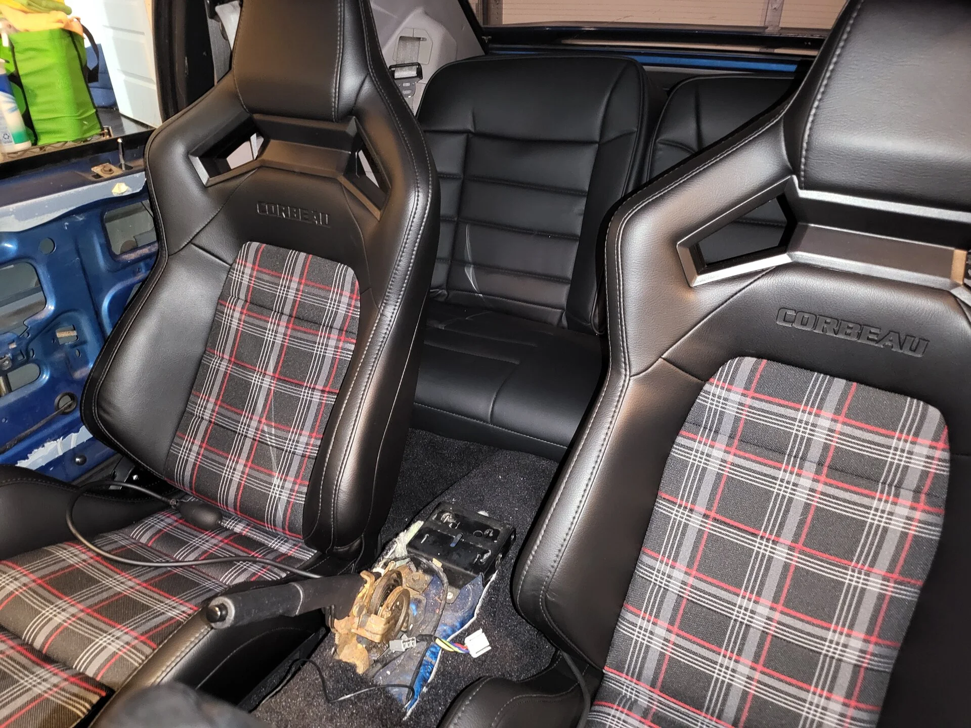

What seats are those? I dig them.
Nvm. Found them.
B
bluestang347
Dec 24, 2006
155
104
53
GA
Feb 27, 2022
  • Feb 27, 2022
Nvm. Found them.
I also opted for the lumbar to be added and would highly recommend it. They were fairly comfortable without lumbar but with it adjusted the seats start to fit like a glove.
Ps the rear seat upholstery is also corbeau and matches the black on the front seats.

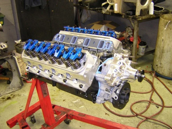

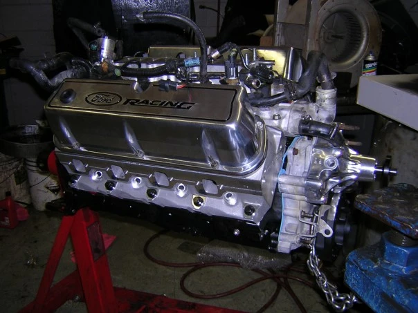

FRPP Z2363 crate engine so it has the ford performance Z2 heads and the 4 bolt main boss 302 block which the block itself is supposed to be good for 1500hp. I was oroginally going to go with a short block from chp and run 11r 205 heads but chp's prices are up about 35% from their site and the lead time was 16 weeks or so. Im going to run the z2363 on low boost with a turbo for awhile before thinking of beefing up the rotating assembly.

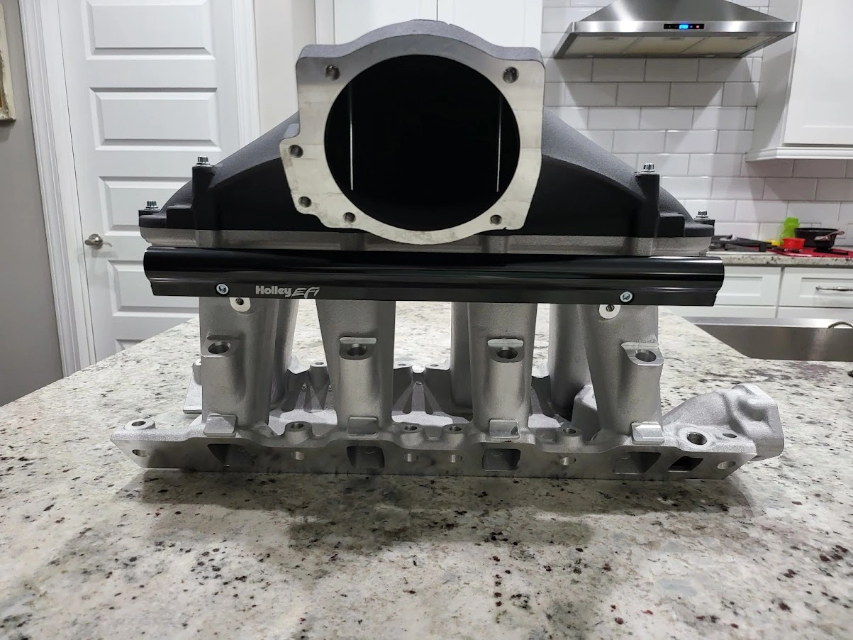

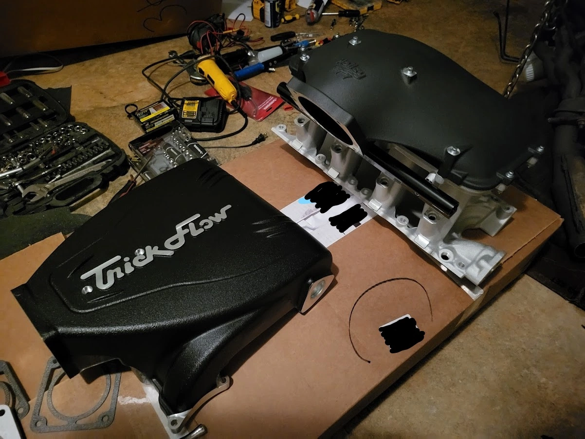

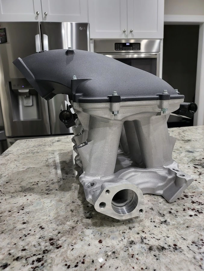

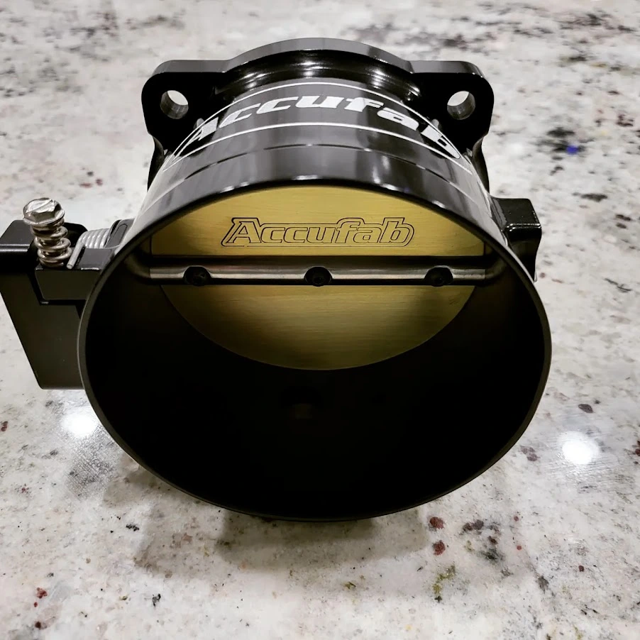

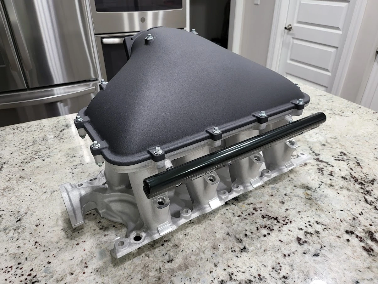

A few updates over the last couple of weeks. I decided to change from a trick flow track heat intake to a Holley hi-ram side mount with a 105mm accufab throttle body. The trickflow lower intake keeps getting delayed and I am going turbo 363 so why not go with the holley. I also test fit the spindles, hubs, baer brakes, and tried out some wheels for clearance.
Reactions: Monkeybutt2000, Cheapskate207 and General karthief

I like that intake alot, what size hood will you need to fit it under?
