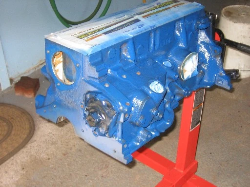

And here is the beginning of a new project.. painting the block :
the old engine was blowned, and I decided to rebuilt one..(2.3T) no performance part, except the forged pistons + Turbo, but it doesn't count :)

Yeah! the color is "Dark blue ford", with the flash of the camera, it looks like original blue ford.. don't know why :)hehe There will be 3 colors: dark blue ford, black, and silver..
Should look clean :)

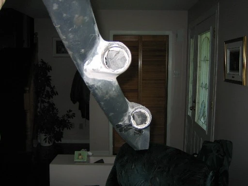

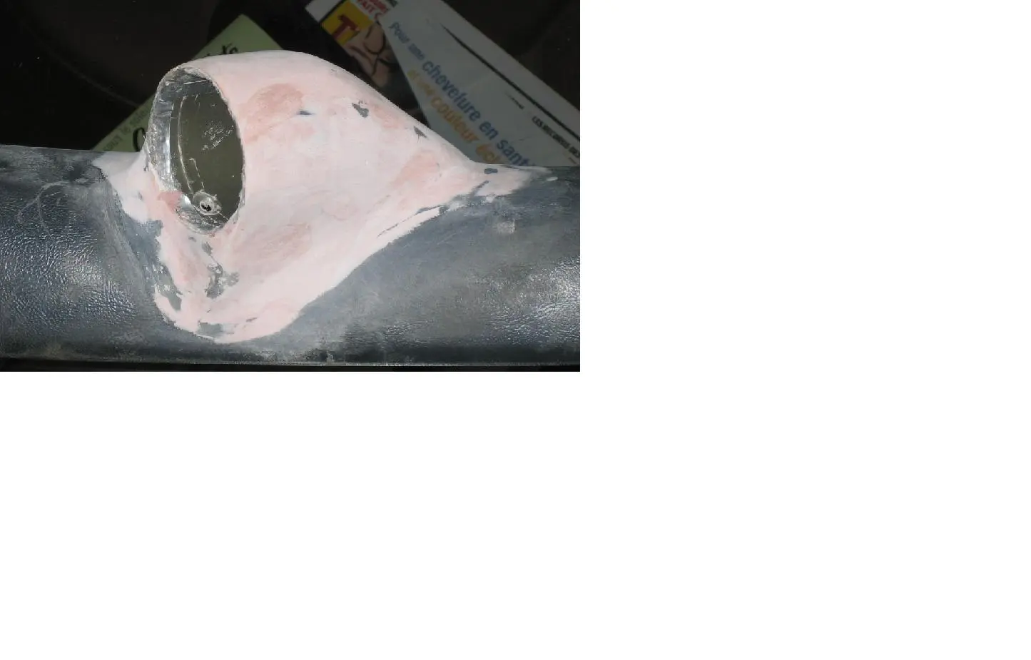

Voila, I'm modifying a stock a-pillar that I bought in a junk yard, from a car exacltly like my car :) same color, same year, coupe.. lol fibergalssing it, make it look okay :)
oops... sorry for the french.. :) I will traduce :)

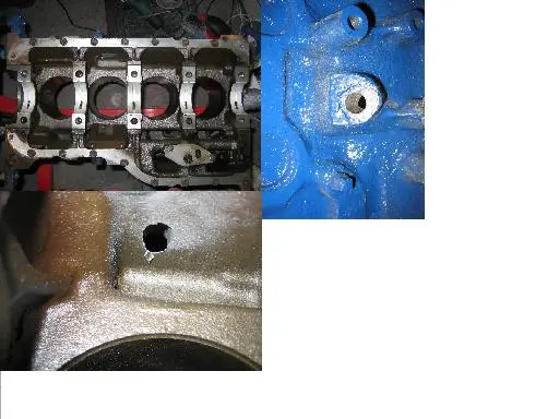

The hole for the oil return line is done...

I would have left the mains in the box until I was ready to put the crank in. Remember to clean them with a cloth and oil. Also if you don't have assembly lube put some gear oil 80w90 and put that on the mains, crank, etc... And in your pic of the hole, I see a nice little metal shaving, make sure non of those are in the engine. Please make sure everything is spotless, that's an important thing that shouldn't be overlooked.
I remember seeing my engine in that shape too... :)
