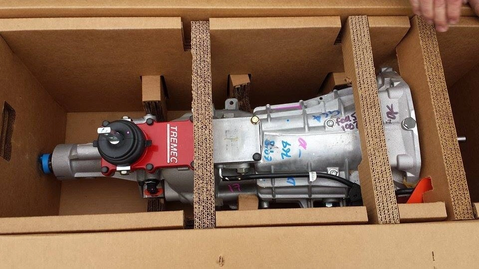

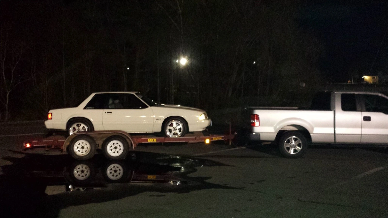

Went to track last week. Popped t5 before I even got it into third. Trailered it home. I bought a viper spec t56 and assorted goodies to replace what's left of the t5.
The 2.66 is going to be nice. I think the t5 is 3.35 first.
I was going to change out my 3.73s for 3.08s or 3.27s but I might stay with what I have. The sixth gear is only a little taller than the factory 5th but it's supposed to knock the rpms down 400 or so. That might make my car tolerable on the highway. Right now I can't hear a passenger.
