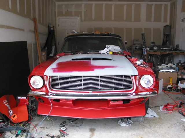

If you are willing to spend a little more money and add a little (very little) more installation difficulty you can get an even more modern headlight kit that uses the "H4" type bulbs. These are not sealed beams at all they use a sealed bulb like your acura that inserts into a housing. You can get them in blue or white, check your local laws though since some states prohibit the blue lights if they are not OEM. I bought a set of these for under $50 bulbs included. Mine have the blue bulbs in them but you can barely tell in the daylight.
The lens that projects the beam has also been modified from what they had in the '60s but I don't think it is similar to your Acura, I know my 2004 F150 seems to point the light further down the road than these do.

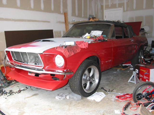

Thanks for the compliment on my car hack, also for mentioning the relays (I completely left that out). He's right of course. If you want to do the high power headlights you'll need to use relays to avoid burning out your primitive electrical system. Here's what I did for the relays, this includes relays for my electric fan electric water pump etc.
http://www.edbert.net/brain.htm
These are the ones that I poked into my rig. They are a huge improvement over the sealed beam, and there are gobs of aftermarket bulbs available for them as well.
Cost was about $75 for the pair. I did isolate them using relays for the high and low beams, I installed all new wiring for them, and used none of the factory harness when I made this swap. You can get new headlight plugs at the auto parts store, as well as the relays. I used #12 wire for everything except the trigger on mine. They function just like factory.
You'll notice a bigger draw on your alternator. They'll brighten noticeably when you accelerate from a stop. A higher output alternator is really your only solution for this. If you look for an alternator from a 94 GT with a 5.0, it should bolt right up to your existing brackets, and with a few simple modifications, you have 130A of power, internally regulated unit, and with the internal fan, it runs cooler.
DO NOT try to just plug some new H4 lights into your factory harness, it's nearly 40 years old, and not rated for the power that these new lights draw. You'll ruin something if you don't rewire. (switch, wiring, plugs, etc.)
