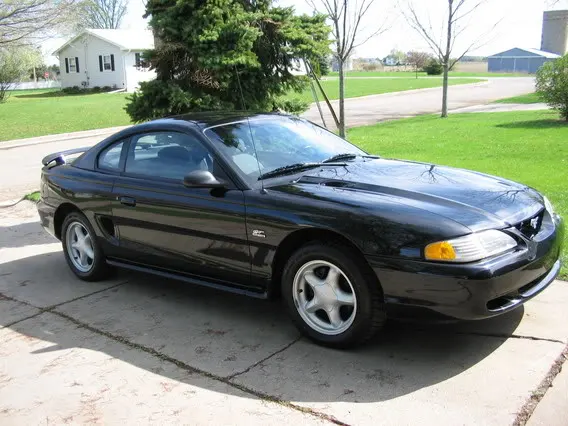

This is what mine looked like the day after the clay bar, polish and wax. The car was fairly shiney before the polish and wax but still looked better after it.
