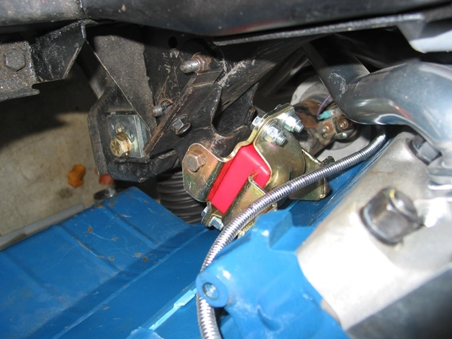

Finally got them installed, they seem to me to be a perfect blend of the strenght of a solid with SOME of the dampening of a soft.

trying to decide.....
how do you like them?
I was think about those or using the stock mounts with a torque strap.
how is the engine height compared to stock?
matt
of the three mounts spoken about here, i prefer the mounts from mustangs plus as i think they are better overall. the prothane mounts are second best as they have similar characteristics as far as safety in case the mount breaks, but they have the advantage of being less expensive. stock mounts i would leave to restorations.
Opentracker said:
Your missing a bolt in your frame bracket.
Nope, there was some sort of small little sub-bracket bolted to the frame mounted portion, I don't know what it was for (possibly a line retainer of some sort ofr power steering?)and I left it off. That is what that hole is for. If you look REAL closely you can just make out the black bolt poking out from behind the shadow made by the flash, that is the upper of the two frame bolts, I can also see the shaft of the upper bolt also hidden in the shadow. The lower of the two is hidden behind the steering input shaft.

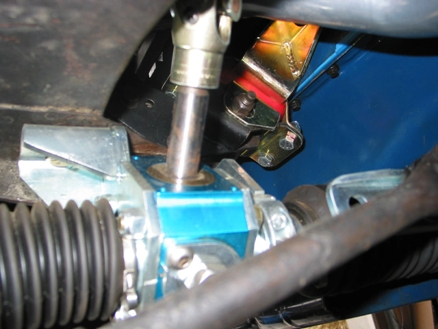

EDIT, the hole you see without a bolt is way too small for the frame bolts. Here's a better shot of the passenger side.

DarkoStoj said:
what about those they have in mustangs plus that are the bolt through design with polyurethane bushings? I think i'm gonna try those out....only downside is they are like $250
Those are the Ron Morris, TCP knock offs. But they did do something nice in the process by allowing adjustment for cars that aren't so straight. Which is about 95% of 'em. I'm not so sure they are as strong because of it, but it's logical.
