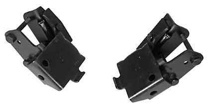

As long as they look like this:
You're good to go.
That's them, the photo Jay posted clearly shows the tab that needed to be cut off, it also shows that small additional bracket I mentioned on the top edge of both mounts. Anyone know what that is/was for?

'67 Mustang SB motor mounts are special one year only parts. The rubber insulator sits at a different angle than the 68-70. the best thing to do is change the frame bracket to a 68-70 small block frame bracket. a side note is that the 67 style small block mounts were actually used on all 67-70 convertibles as well. if you hold a 67 and a 68 small block frame bracket side by side you will see why the insulator is different. there is one bolt hole drilled in a different spot which causes the frame bracket to sit at a shallower angle which is why the insulators are different. any good parts place will list 67 insulators as they are available but the 68's are cheaper and make it worth swapping the frame mounts (plus you can get urethane mounts for 68-70). you can force the 68 insulators onto the 67 mounts but they will fail earlier. it is easy to tell if you have the right parts as the bolts will slide right in with no effort. now having said all of that if your shock towers have moved at all the angles will no longer match up properly and complicates all of the assembly. if somebody tells you the parts are the same they have not looked it up in a Ford parts book or have compared the parts themselves. the national parts catalog (NPD) does not list the mounts correctly but the paddock catalog does. hawkrod
The following was posted by David Suesz over on FoMoCo.com and gives a clear picture of what Hawkrod was talking about:
getimage.asp
It shows that the holes in the 67 frame brackets are higher than on a 68 and later. To maintain the same crankshaft centerline, the 67 mounts have to be "shorter" than the later ones. Unfortunately these unique mounts are not widely available. And if you put a mount from a later model on a 67, then the engine sits higher. It's my belief that the Prothane mounts are made for the later frame brackets.
The diagram identifies ALL verts as having the 67 style frame brackets up through 70 so, Mr. Edbert, I am confused about how you are able to use those Prothane mounts, unless your frame brackets had been changed.

Me too, but they fit easily and you can see they're on there in the pictures.:shrug:
I bought this car in 1987, there was a 20 year period where just about anything could have been done to it without my knowlege. At least the stuff you posted is good info, it also reinforces my recollection that vert mounts were different somehow, IIRC they tried to lower the CG to help prevent rollovers.
Jay, does your parts list show different brackets too?
