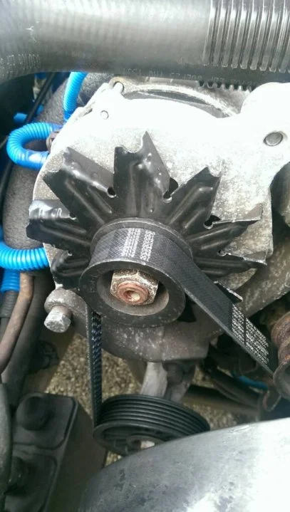

I more concerned with the balancer.. I've never replaced one before. I already did the pulley kit. I left the alternator pulley stock... Sorry for the possible dumb questions.
If you left the alt pulley stock, it is going to turn slower regardless, as you decreased the size of the crank pulley. You now need to reduce the size of the alt pulley to compensate. I think it's 1 11/16 or 1 7/8 size that is needed.

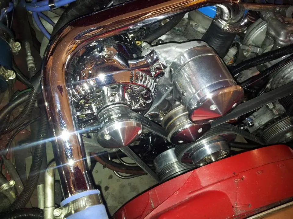

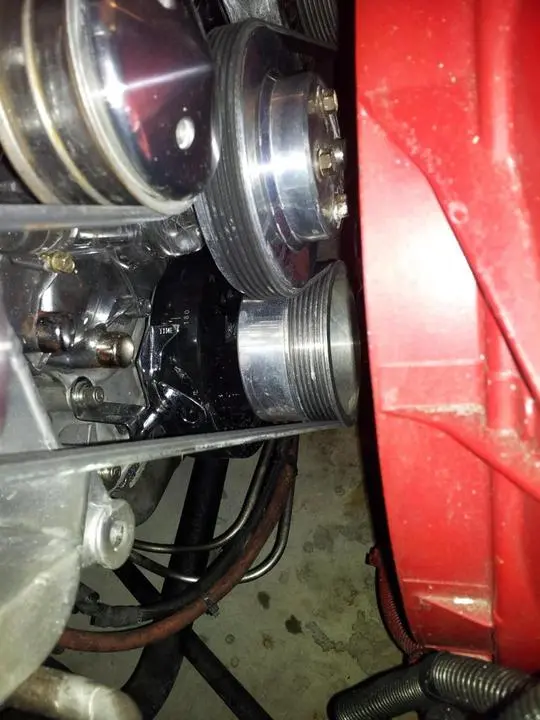

Here is a pic of my seteup. You can see how small an alt pulley I am using. I also have a Pioneer SFI balancer .

Ok I will have to take the alt off and take it somewhere that has some air tools. I can't get the pulley off.. Also thank you for the input on the balancer. I appreciate all the help. I'm not the smartest when it comes to Fox body's, but I do know a little and I'm willing to learn..
