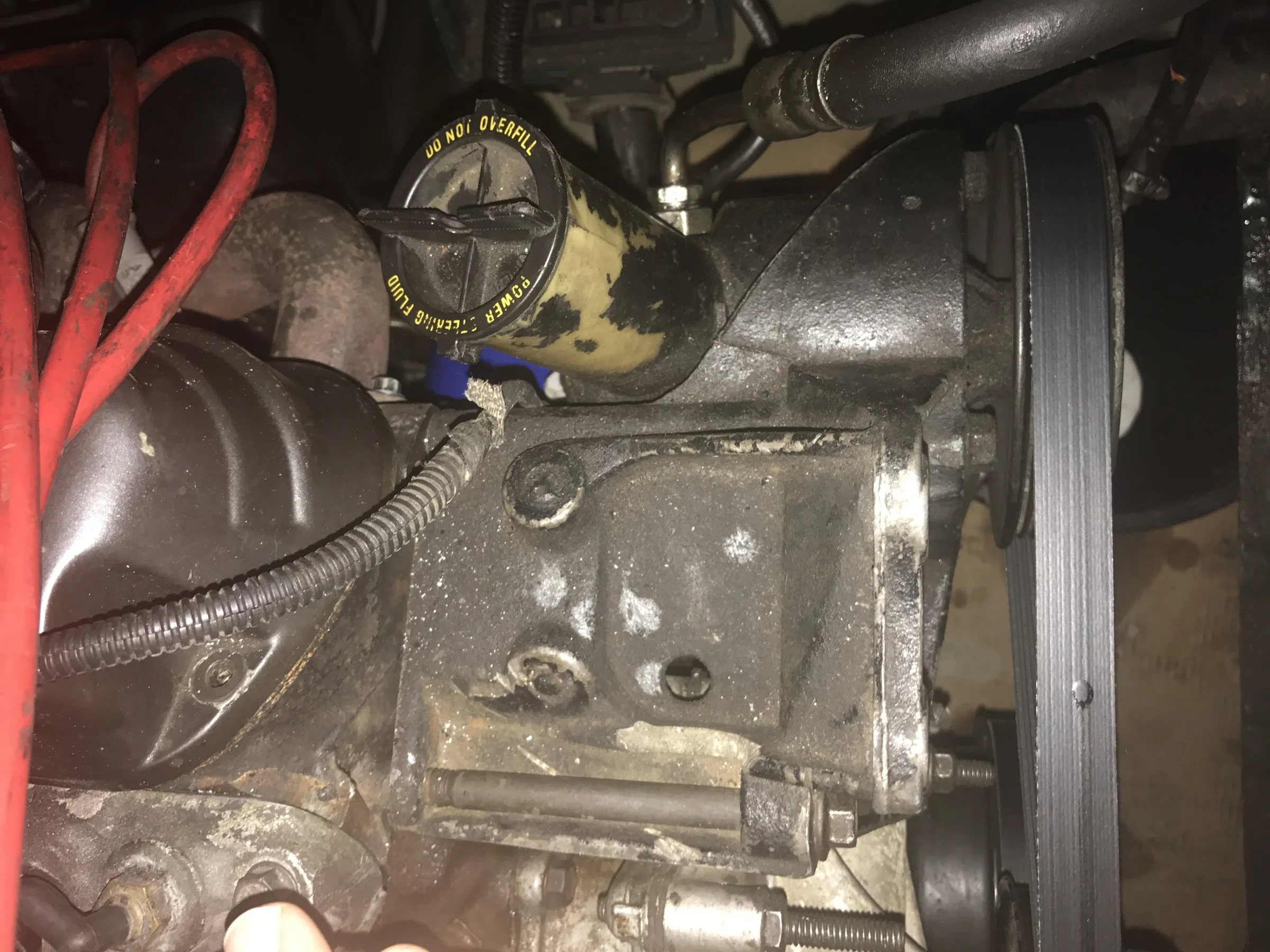

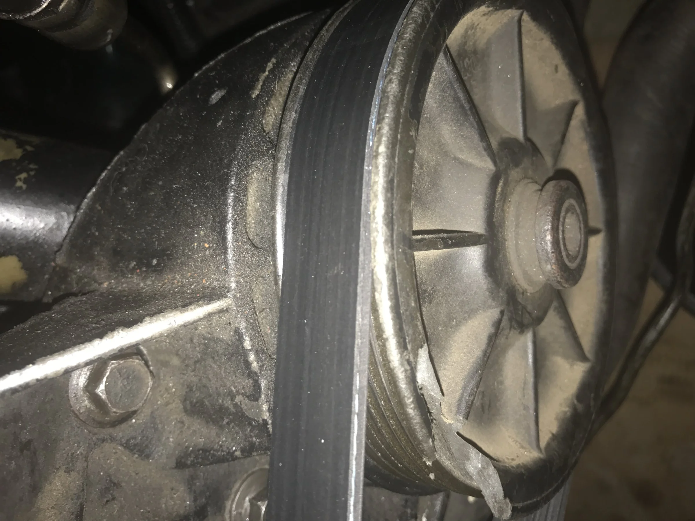

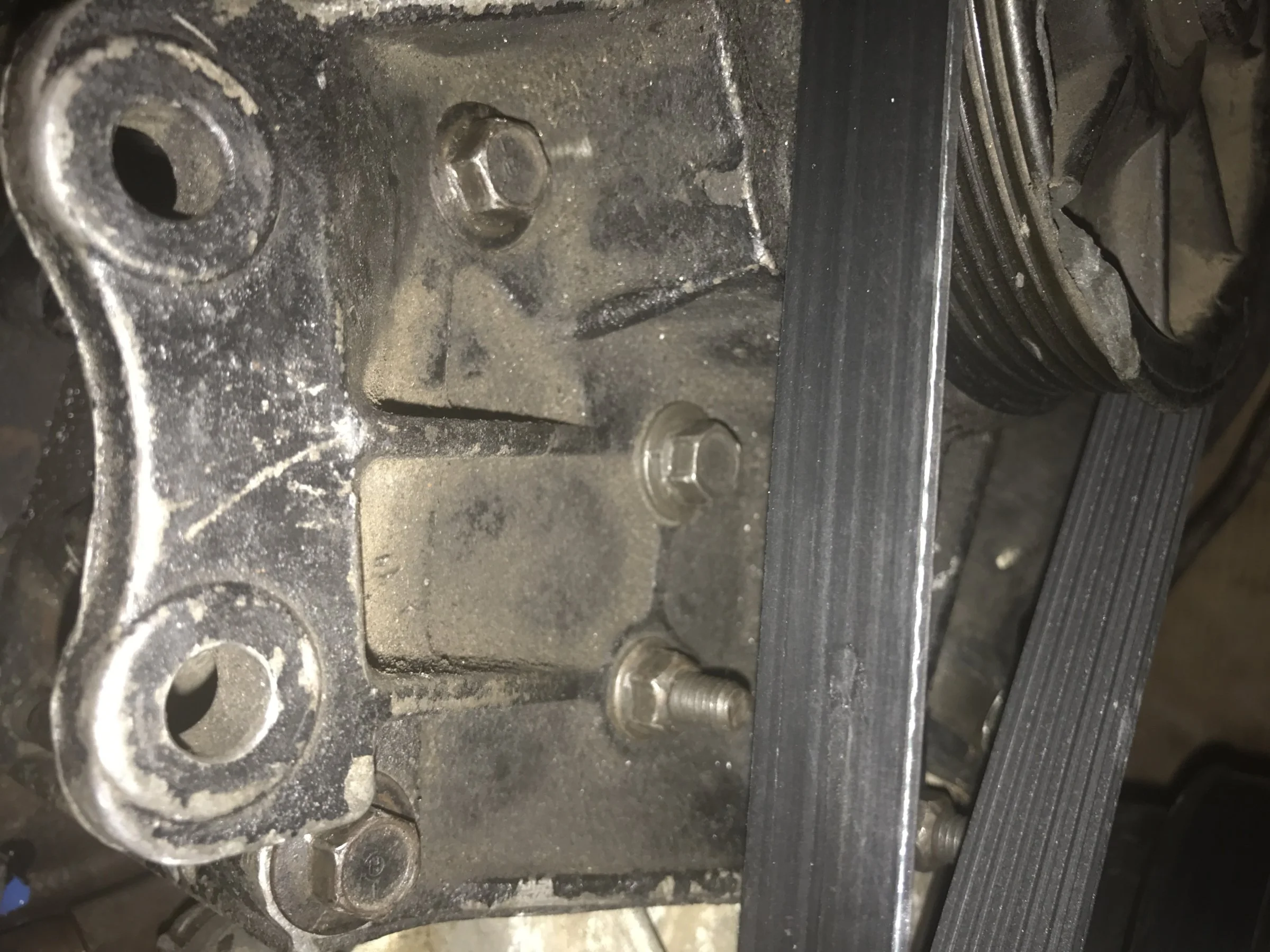

Here's couple more photos of just power steering pump and bracket. Any info you guys can provide would be great!!
Any better pics of PS pump and that bracket?

Hey I've looked and looked no part number in the bracket or pump. I guess biggest question I have is if I buy the ac delete bracket will it work with my setup? I did find day me numbers on the heads that they are off an 86 5.0. But even in 86 they didn't have this bracket. I appreciate all your guts help with all my projects.
Honestly, don't know. Tried googling some other 5.0 setups and nothing matched up. You have an part numbers visible on the bracket, pump and pulley?
If you did the AC delete kit that relocates the pump, it would replace all the bracketry on the drivers side of the motor. Problem is your pump doesn't look like standard fox pump and you'd need the fox style PS pump bracket that isn't included in the delete kit
I can't seem to find anywhere a power steering bracket or the bracket and pump combo. Is there any other car that has same power steering pump setup as fox body? Maybe I can pickup bracket from salvage yard that way..

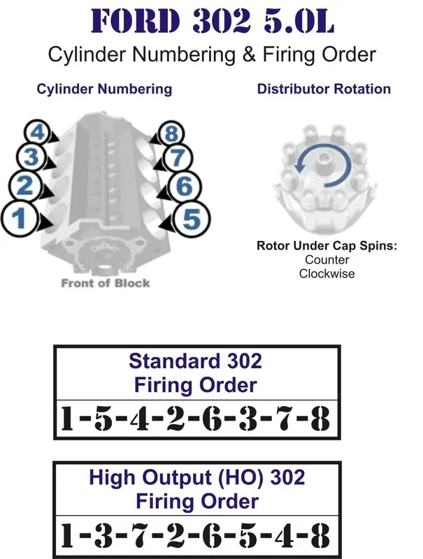

They typically use a standard 302 firing order , so can you look at the dist and tell what firing order it's using?

What he said^. Try arranging the plug wires using the HO firing order. If it runs like dog poo, then it is a non-HO 5.0. Based on how those pulleys look, that came from a passenger car that was not a mustang, so I doubt that is an HO engine, unless it came from an 86' lincoln mark 7 LSC (not sure how their pulleys look though). The 86' HO mustang accessory pulleys look like the 87-93 HO mustang pulleys. I would look for an 87'-93' HO engine and sell that one. 87'-88' 5.0 HO's were the best (not including 93' 5.0 cobra engine) since they had a slightly more aggressive stock cam, compared to the 89'-95' 5.0 HO engines. But any 87-93' 5.0 HO engine would be a decent choice. Oh, and beginning in 93' they used hypereutectic pistons instead of forged pistons. Technically the forged ones are stronger, but for an non boosted application, it shouldn't cause any problems. If anything, they are better for naturally aspirated applications since they are lighter in weight and expand more quickly to avoid any slight blow-by during cold engine operation.
As I read the lmr tech notes it eliminates the ps bracket
It also assumes running a standard fox PS pump, which he isnt
If he had this pump and the bracket bolted to it, then why could buy that AC relocation kit and just yank all that stuff.
Really needs to ID what he has first before buying parts. For all we know there could be alignment issues with other side of accessory system.
Any more pic of the motor? Perfhaps we can find clues as to what it's out of. Any part numbers on the pump?
Edit: actually the pump looks like it could be fox but the bracket it bolts to is def not compatible

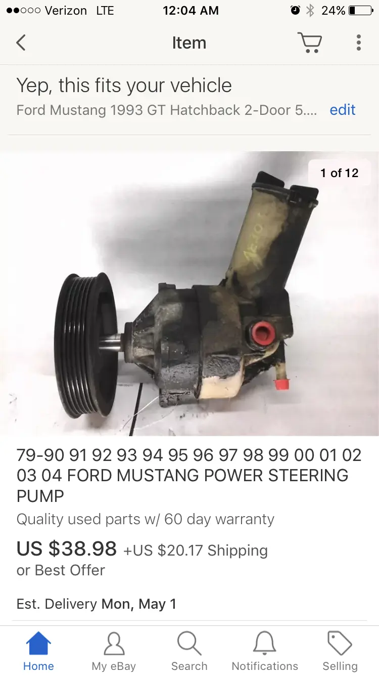

This says pretty much any power steering pump will work from 79 on. I'm gonna pull this off soon clean it up and see if there's any part numbers on it..
