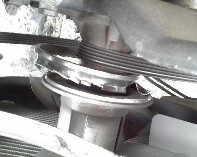

pully ripped in half??
primedfox
Jan 31, 2008
11
has anyone ever seen this happen??? i was driving down the road normally and i come to a light and it seemed like just my belt broke. I pull over pop the hood to see my waterpump underdrive pully basically shered in half!!!
That's pretty wild. What brand is it? Do you have any other accessory drive modifications? Were the bolts loose on the pulley?
I had a similar problem, when the bolts loosened on my crank pulley. It eventually led to a crack in the pulley, and the resulting wobble had me confused for weeks (you couldn't see the crack while it was installed), because it looked straight when the engine was off, but apparently had an intermittent wobble while the engine was at higher rpm. Destroyed a few belts before I finally pulled it and the damper, and discovered the crack.
I've heard guys mention that they had worn areas on their aluminum pulleys, but I've never seen one sheared in half. It's probably why March and some other companies now hard coat the high wear area of the pulley.
