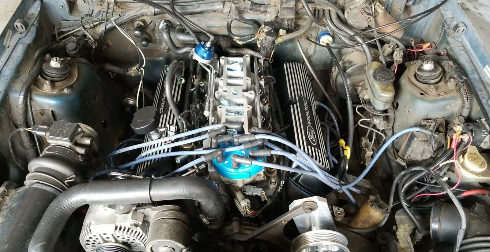

i want to get the old fuel in my tank out before i run it thru my new injectors, ill attach a pic of my engine how it sits now. i have everything aside from the upper intake and what would attach to it. a few vacuum and coolant lines as well as a couple plugs that would go into the intake and throttle body etc. im wondering if i can just turn the car over so the fuel pump activates for a few seconds like it normally does forcing what fuel is in there thru the lines into a bucket. repeat a couple times with a fresh gallon of gas just to make sure im not running any garbage thru new parts. is this as easy as im making it out to be? any tips would be appreciated.

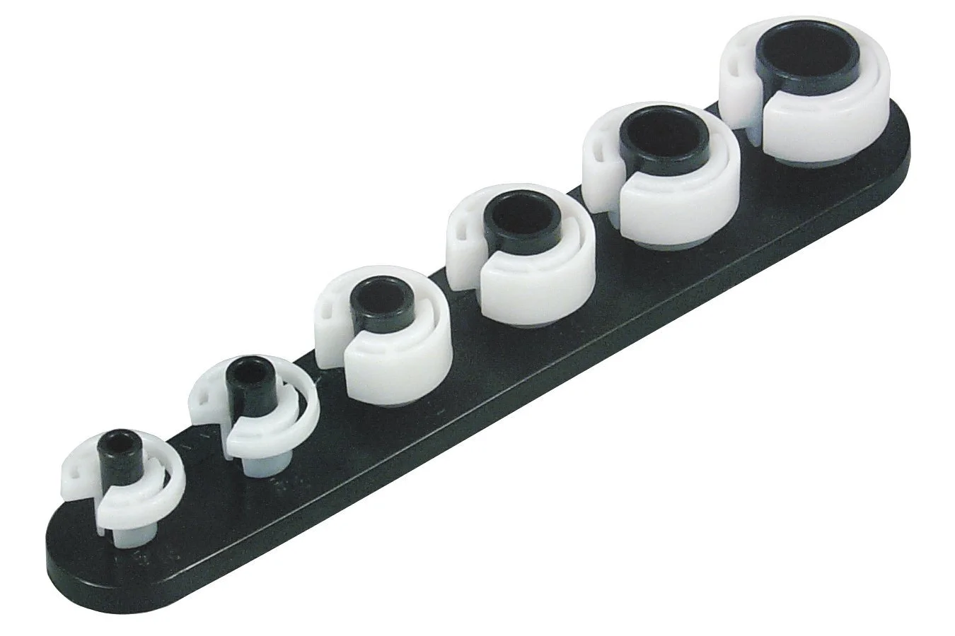

1.) Separate the pressure line (the one with the Schrader valve on it) using the fuel line tools.
Look in the A/C repair section for the fuel line tools. They look like little plastic top hats. You will need the 1/2" & 5/8" ones. The hat shaped section goes on facing the large part of the coupling. Then you press hard on the brim until it forces the sleeve into the coupling and releases the spring. You may need someone to pull on the line while you press on the coupling.
