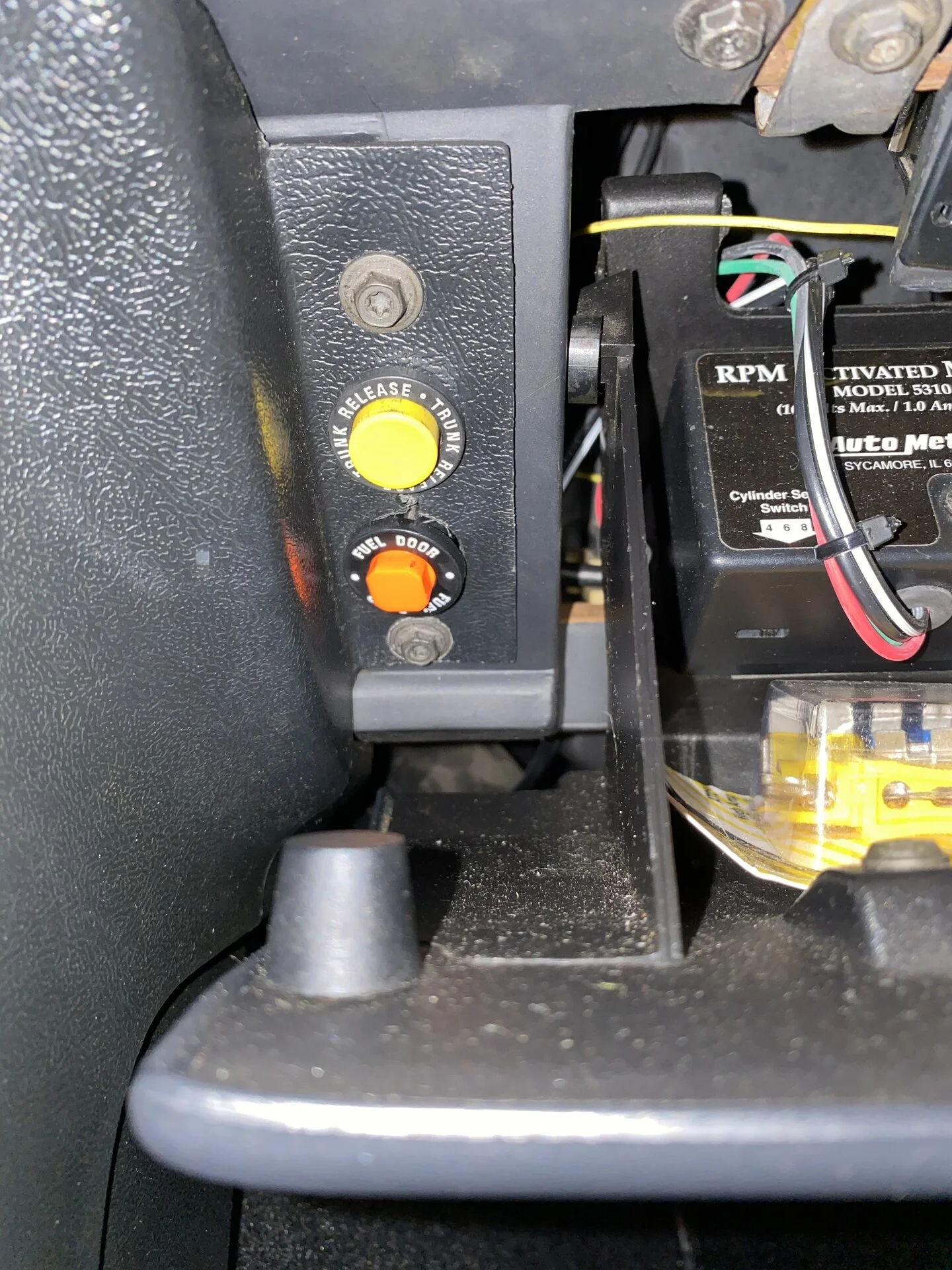

The wiring should be present if it was available as an option. Is there a hole in the console under the glovebox where the button goes?
You need the button, and the popper mechanism
Look back there where the fuel door button is and see if there is a connector with two wires
Thank you!I have an ‘86. The buttons are the same as Mustang5L5 shows on his.
