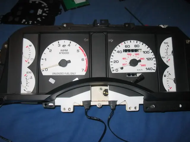

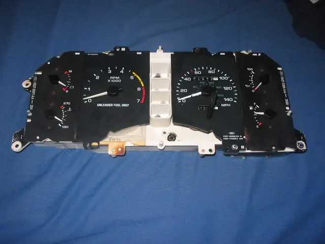

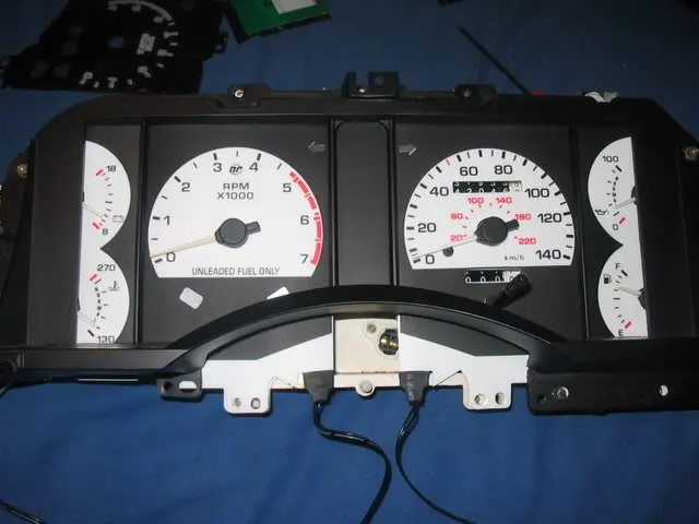

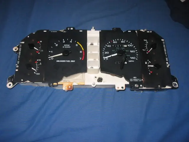

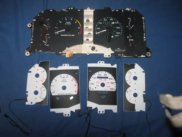

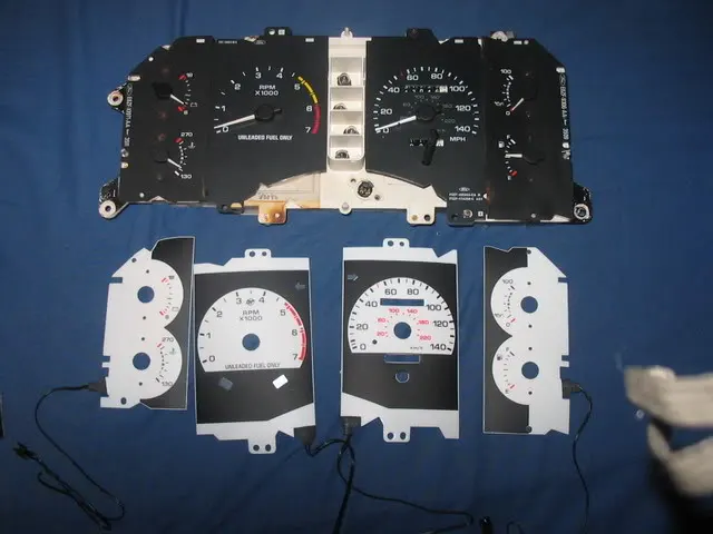

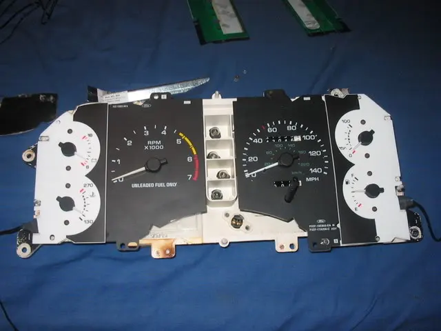

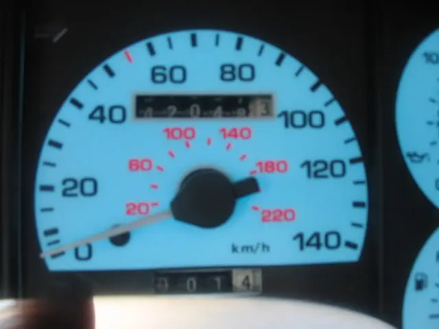

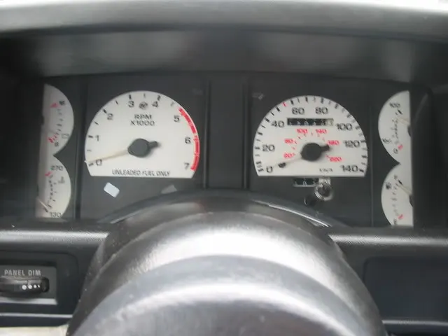

put them on a few mins ago, now its time to go wire em.
here are a few pics till i get them wired up!
i like em!

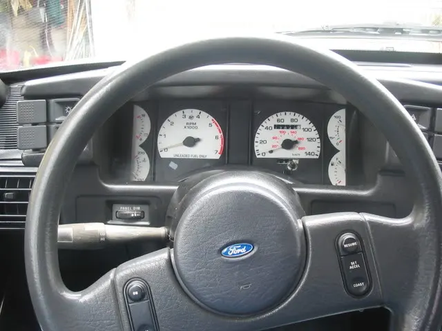

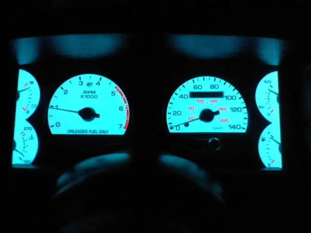

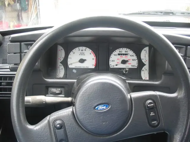

SWEET ryan!! look just like mine buddy! wait till you get em hooked up and see them at night! you ll like them even more! are you going to mount the little dimmer pad where i told you i have mine mounted? i like it there kinda hiden! good luck with the install! James
Ryan, i don't have my wiring diagrams anywhere handy so i can't tell you what wire to use. Just hook the black to the metal frame and the red needs to go to one of the wires on the dimmer. I beleive it may be the blue w/red tracer wire. I think that wire can also be found on the headlight switch if you want to tap it there
thanks.. ya i just used the brown wire from the headlight switch for power is was 11.54 so it was close enough to 12v

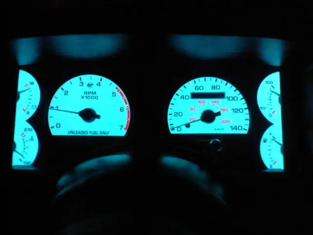

there so damn nice imo

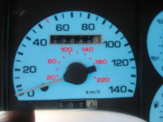

this is in the day time, im ready for how they will look tonight! although i think i may grab some neddle paint and paint the neddles red or orange though so i can see the neddles better in the day time!
and i like the blue more then the green!!

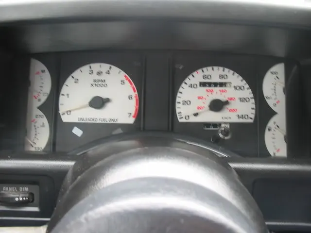

Same ones I bought, I found out about NR Auto when I watched Ackbar's videos and saw 'em. They get lots of compliments at the cruise-ins and what not.

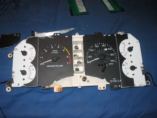

The instructions are retarded and mostly useless. First they said take all the bulbs that illuminate the gauges out. Then at the end of the instructions they said leave some bulbs in to illuminate the needles and odometer!%$# I have one bulb in there right now behind the odometer and I can see all the needles fine. I will take everything back out and paint the needles fluorescent orange though.
