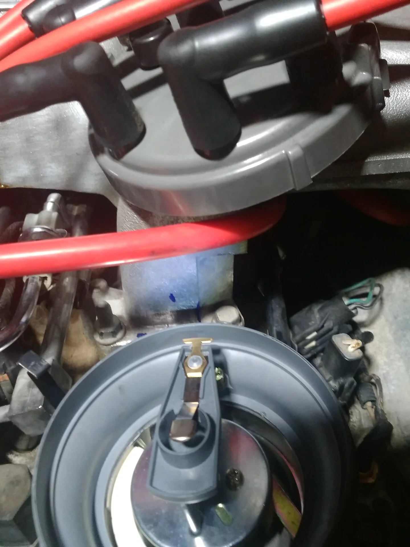

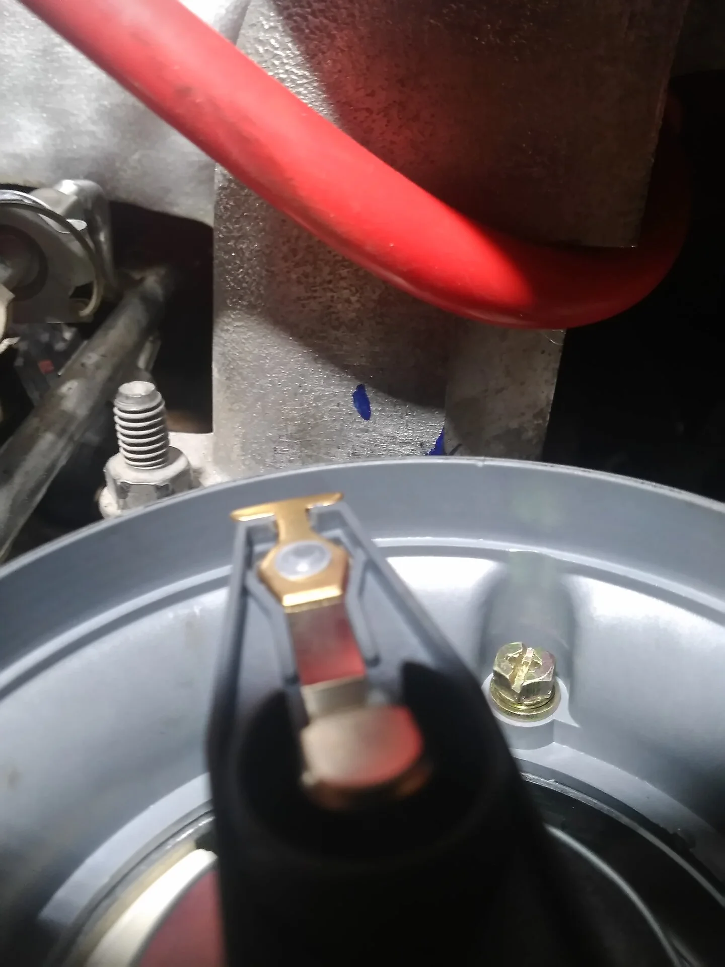

So I'm stabbing a new distributor today but I want to be as certain as possible I have the correct one. I purchased an Steel gear and the one I pulled from my mostly stock 89 was the, I believe, original motorcraft. Part was E4ZE-12131-AA. Any ideas?

What could happen if I start the car and it's one tooth off? Will it just not start or cause some other horrible problem. The new distributor will not line up exactly where the old one did. Of course the old one was causing me problems like backfiring and such.
Square one:
Make sure you are at tdc
Drop the distributor in so it lines up with the #1 spark plug, using the distributor cap to mark #1 on the distributor body.
It may not be exact, just close.
Start engine and set base timing.

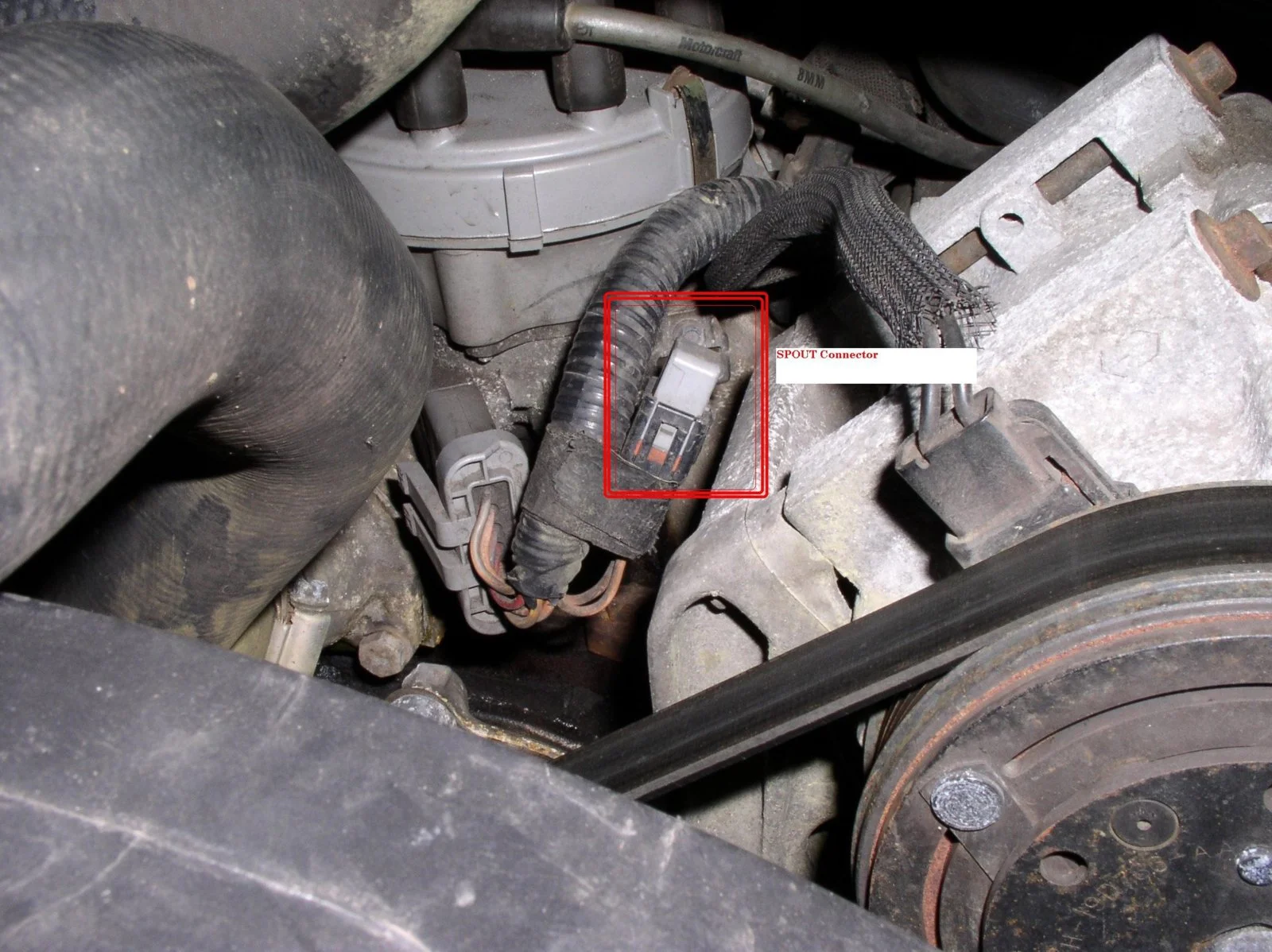

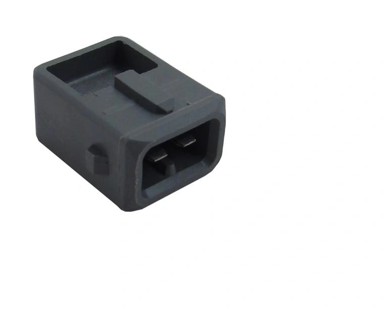

Remove the SPOUT jumper
It is the 2 pin rectangular plug on the distributor wiring harness. Only the EFI Mustang engines have a SPOUT. If yours is not EFI, check for a SPOUT: if you don’t find one, skip any instructions regarding the SPOUT. The SPOUT (Spark Out) enables the computer to control the spark advance. When the SPOUT is removed, the ignition timing reverts to the base ignition timing set by either the spark rod inside the distributor or the physical position of the distributor.
Warning: there are only two places the SPOUT should be when you time the engine. The first place is in your pocket while you are setting the timing and the second is back in the harness when you finish. The little bugger is too easy to lose and too hard to find a replacement.
Start engine, loosen distributor hold down with a 1/2" universal socket. Shine the timing light on the marks and turn the distributor until the mark lines up with the edge of the timing pointer. Tighten down the distributor hold down bolt, Replace the SPOUT connector and you are done.
